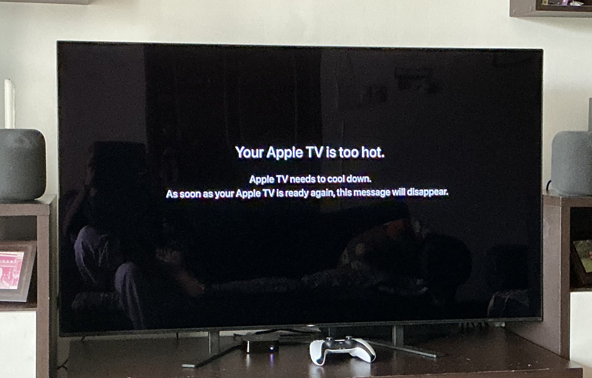

I live in a hot country and have been watching high-bitrate content on Plex for a long time. Had never had problems with the Gen 1, but the Gen 3 does not seem to have sufficient passive cooling to sustain this for more than 15-20 minutes. At first, the content starts stuttering, then everything stops with the below error.
Just a PSA for anyone who plays high bitrate content looking to upgrade.

I wonder how I deal with this situation. Normal streaming doesn’t have any issues, so I can’t just go to the Genius Bar and start playing questionable material from my Plex. It’s already outside the return window, too.

A mini fan or lower AC setting?

Yours has a fan, the 3rd gen doesn’t.
I further discovered that if I change my HomeKit hub from the Apple TV to one of my HomePods, the heating problem is less frequent. I have 2 cameras and around 6 HomeKit devices.
That posts mentions the Apple TV doing the decoding with CPU, do you not have a Plex server doing that then just streaming it to the Apple TV?
That makes sense then. Try Infuse, your Apple TV should accept most of the video codecs without needing to transcode in the server.
Yes, I am using infuse for movies for the time being, but I keep having to go back to Plex for Live TV & DVR, so it’s not a full replacement.
It is a known issue on the 2022 ATV4K3.
But, mostly impacts games, and some content on Plex. Using a heatsink with a fan will most likely help.
I am hoping that the next ATV has active cooling.
Reactions: orbital~debris
Get a long HDMI & power cable and keep it near AC or a fan if infuse Is not an option.
