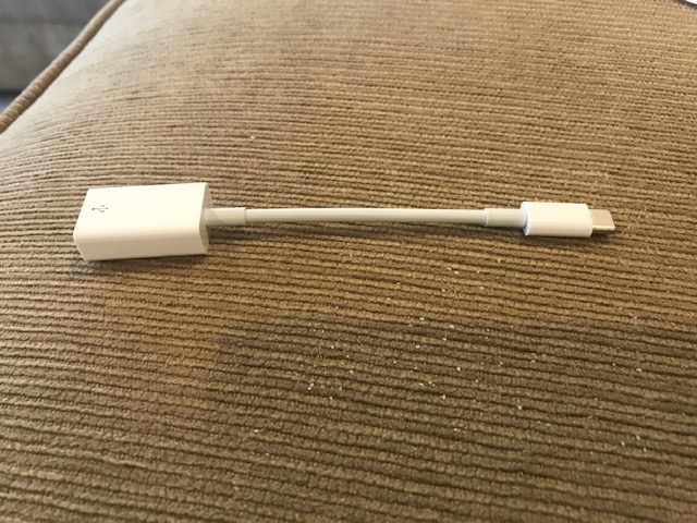

In a bit of a similar situation, I had a problem with my recent MBP which I use 100% of the time with a BT mouse. Suddenly, the mouse stopped working. Changed the batteries and same situation. I rebooted the unit several times and still it didn't work. Effectively the MBP is now a door stop. With the 2 USB-c outputs, NO way to connect a wired mouse. After an internet search, found several male USB-C to female USB-A dongles for about $6, but needed to access my MBP NOW.
Off to Walmart where they had a zillion USB-C and USB-A whatevers, but all the wrong gender. I was about to give up, but then noticed Walmarts Locked case for Apple gear. Saw one that was exactly what I wanted (Apple priced at $20). Coughed up the double sawbuck and I was back in business.
Thanks Apple for deciding what ports I needed on my MBP. I should note I've had the MBP for nearly 2 years and this was the first time I missed having a USB-A port. I also should note my BT mouse immediately started working fine when I hooked up my wired mouse. Unplugged the wired mouse and haven't had the problem since. Have no idea as to why the MBP locked up as it did.
If nothing else, I would certainly recommend buying one of the $6 no-name USB converters as a backup for access to any USB-A device you may have.
Apple's $20 access to a USB-A
