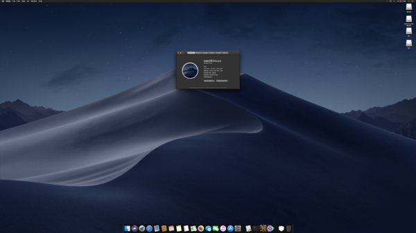

I thought you guys might be interested to know, I recently got an Atari VCS to boot natively on macOS Mojave 10.14.6.
The VCS features an AMD Ryzen 1606G 2.6Ghz chip, Ridge Raven 2 chipset and Vega 3 (Picasso) graphics.
And yes you are looking at 4K output!

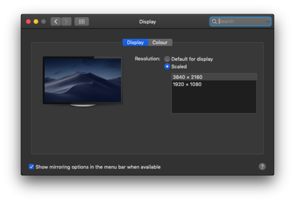

Is the 1920x1080 mode a HiDPI mode?

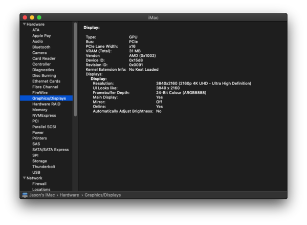

There's no acceleration for the GPU, how's the performance (scrolling, video, ...)?
For the display mode, no that was in 4K not 1920x1080. But I believe it is HiDPI.

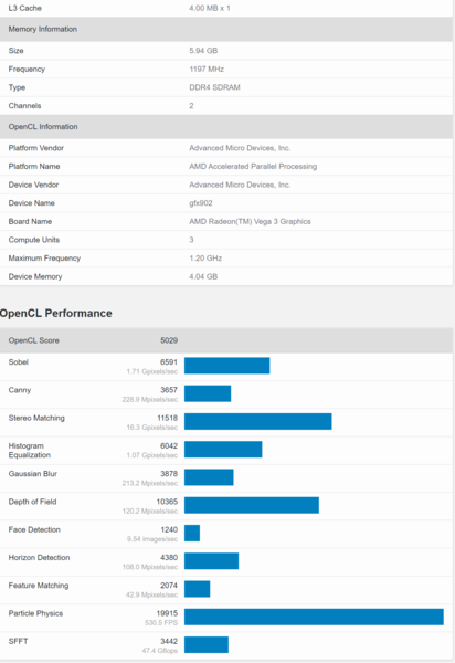

Yes I'm aware of it, but it reports okay and boots fine (as VESA mode). I was quite surprised this actually occurred. Video playback is no problem and very smooth, but sound is not available (as expected, because it doesn't have any AMD codecs available). So I use a 3rd party USB DAC from Cyberdrive instead which works pretty well. For the AMD GPU I currently have 31MB VRAM available on the system.

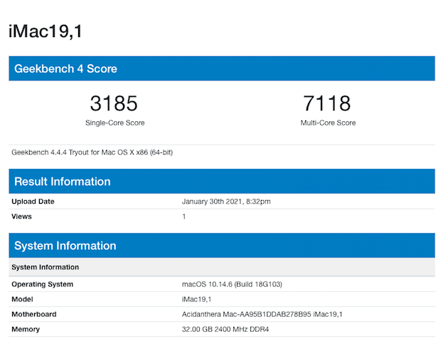

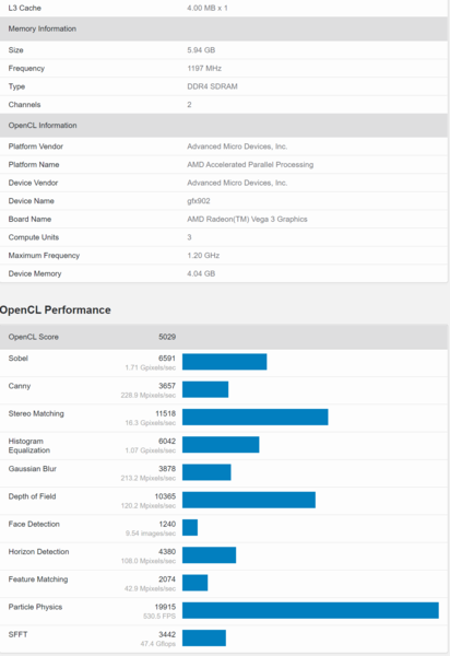

For performance this is what I got from Geekbench:
Yes, I understand you were showing the 4K mode.
My question was, is the 1920x1080 mode actually a 4K mode with the x2 scaling (for HiDPI) which means that it is only supporting one timing - the 4K timing - which is the default from EFI in this case. Then if you wanted to use a different timing, then you would override the EDID or something so that it boots to the desired timing before macOS starts.
As far as I know, it was booting into the 4K mode natively - I didn't use any EDID settings but did install a Vega56.aml SSDT. The CPU&GPU is capable of supporting up to 3x 4K displays, so to answer your question - yes it likely to be the case (default from EFI using 4K timing). It is a pretty powerful graphics card, I was really surprised. Even with only 31MB VRAM available and no 3D GPU I am getting some decent performance. The option to display it at 1920x1080 was already available when I finished installing Mojave (which is decent). Only problem left now other than onboard audio is the SATA-USB drive connection and WiFi. The USB works with some SATA drive combos and not others (for some reason) and the Open Intel Wireless drivers aren't seem to be working on this setup. I'm currently testing SATA-unsupported.kext to see if it works.
