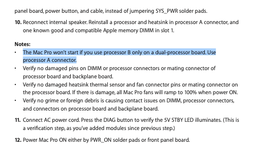

So I assume that if both the CPUs aren't working in a dual-processor Mac Pro, there isn't a built in "failover" that allows it boot off just one?
(Later today, I am going to replace the stock X5550s, just to make sure I didn't do something stupid when I swapped the CPUs out. But I think I was very careful.)
Install one Xeon to CPU socket B A.
Reactions: OldMacPro2
