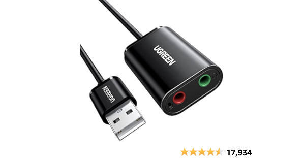

USB audio adapters come in different configurations. The inexpensive ones are USB to 3.5mm in and outs, like this one:
If you get one just go ahead and get one that has both ins and outs.
Pricier boxes have more professional features (1/4", XLR, MIDI, phantom power, separate headphone out).

If all you have coming out of the synthesizer is an analog 3.5mm pin output, something like what Brian Baughn has posted in reply 4 above should work.
