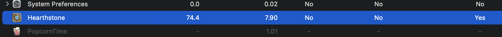

Hi, seems like with the last few betas of Big Sur I noticed with automatic graphics switch it always stays with the integrated even when I open a game it doesn't switch, even if I turn off auto switch and open a game in the activity monitor shows like is not using discrete card. The only app that I've seen using it is Unity and because there is an option to pick graphic card to use.
Anyone else experiencing this? if so maybe there is a workaround?

Thanks for your suggestions. Those games and apps used to use discrete card few betas ago this started happening since like beta 5. I know I can force I just hoped there was a better workaround I guess I will have to wait until they fix it. Also was wondering if there was someone else experiencing the issues.

I've been using Big Sur since beta 3 flawlessly until beta 6 I started seeing weird graphic glitches some times then I noticed some apps and games wasn't using discrete card no matter what. I already tried resetting SMC and NVRAM but that didn't help I hope it gets fixed soon.
