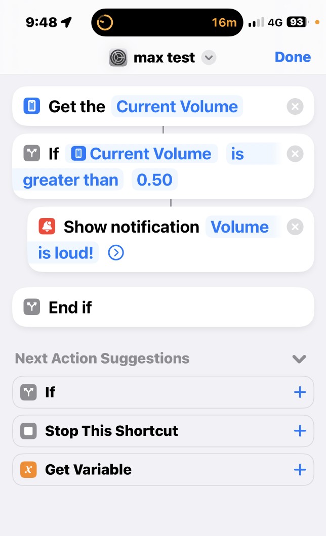

I can find the "Get Volume" in the Shortcuts App, but not in Automations.
I'm trying to have an automation that will detect when the media volume is very loud. (e.g. by accidentally holding down the volume button and inadvertently the volume is 100%). I want a notification on the Lock screen. (plus Siri if possible).
I can do most of this if I run a manual shortcut, but that is little help. I need it automatic in Automations. I am still learning scripting/programming.
Any help will be appreciated.
