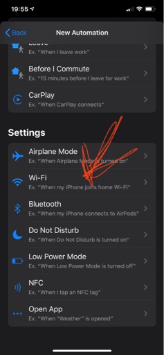

I can’t find the option to trigger an automation when leaving a WiFi network or when quitting an app. Do they exist? There are triggers for joining a network and opening an app, but I also want the opposite.

In the Shortcuts App you can set those WiFi Automations.
Use case #1, can set it up as a "when I arrive" automation and a "when I leave". But even then, you will need to tap the "Run" button on the notification from Shortcuts for it to happen.
#2, only automatic-ish ones are for Apple Watch Workouts: there you can start a workout, start another app, and do the wifi and DnD. And when you end the AW Workout, turn back on DnD/wifi, but can't stop an app.
At this point, Automations are not much of a step up from doing this type of stuff via a Shortcut, imo.
I tried that and they rarely triggered. Occasionally they would, but most of the time they didn't. Also, yeah, having to wait for the notification, then click "run", isn't what I'd call an automation but that's a general issue with Apple's implementation. I doubt they're going to change that, unfortunately.
