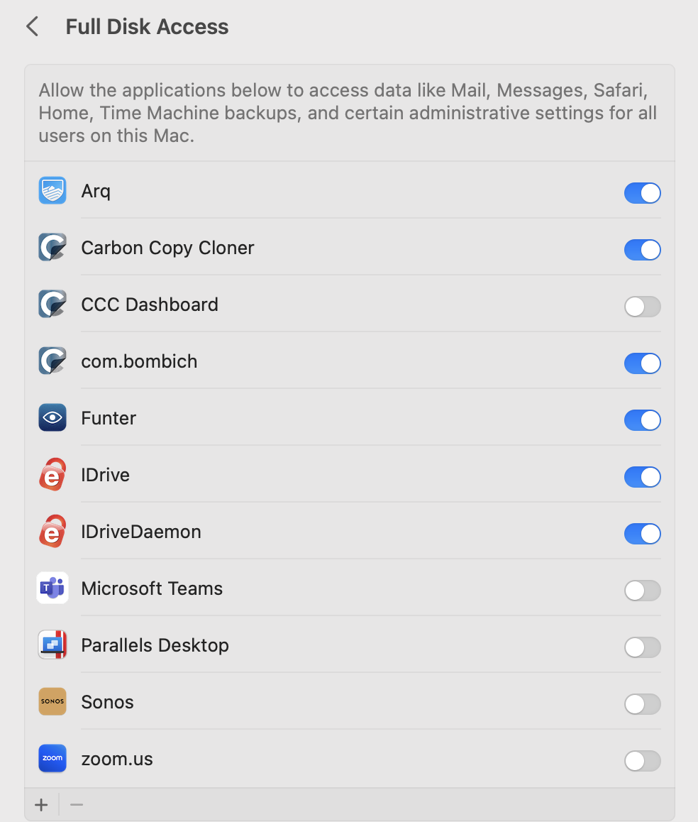

2. Backup Log Error Message: The attached PDF file is a sample of the error logs that I am consistently getting. The error log indicates that i) the backup failed and ii) there are 91 files not being backed up / errors despite having granted full disk access to Arq.
a. What is the cause / reason for the files not being backed up / resulting in errors (i.e., is there a reason these files cannot or should not be backed up?)
b. What is the fix / solution (i.e., is there a need for the files [and, if not, then can they or should they be excluded from the backup], is this problem common to all macOS backups, is / should this be a concern)
You are trying to read files protected by file permissions. They all look like Spotlight cache files which you don't need to backup.
Either a) exclude cache folders, etc. or b) "skip items excluded by Time Machine rules" on exclusions. I skip items excluded by TM which have no value when wanting to recover as they all be recreated by macOS.
I don't use the "backup all drives" style of backup. I prefer to "choose the folders to backup". This seems to me to more in keeping with recovery from a serious disaster (e.g. file or theft). I focus on the folders with data important to me personally rather then important to operation of macOS.
I am trying yoru suggested approach. I deleted three "folders" as follows:
