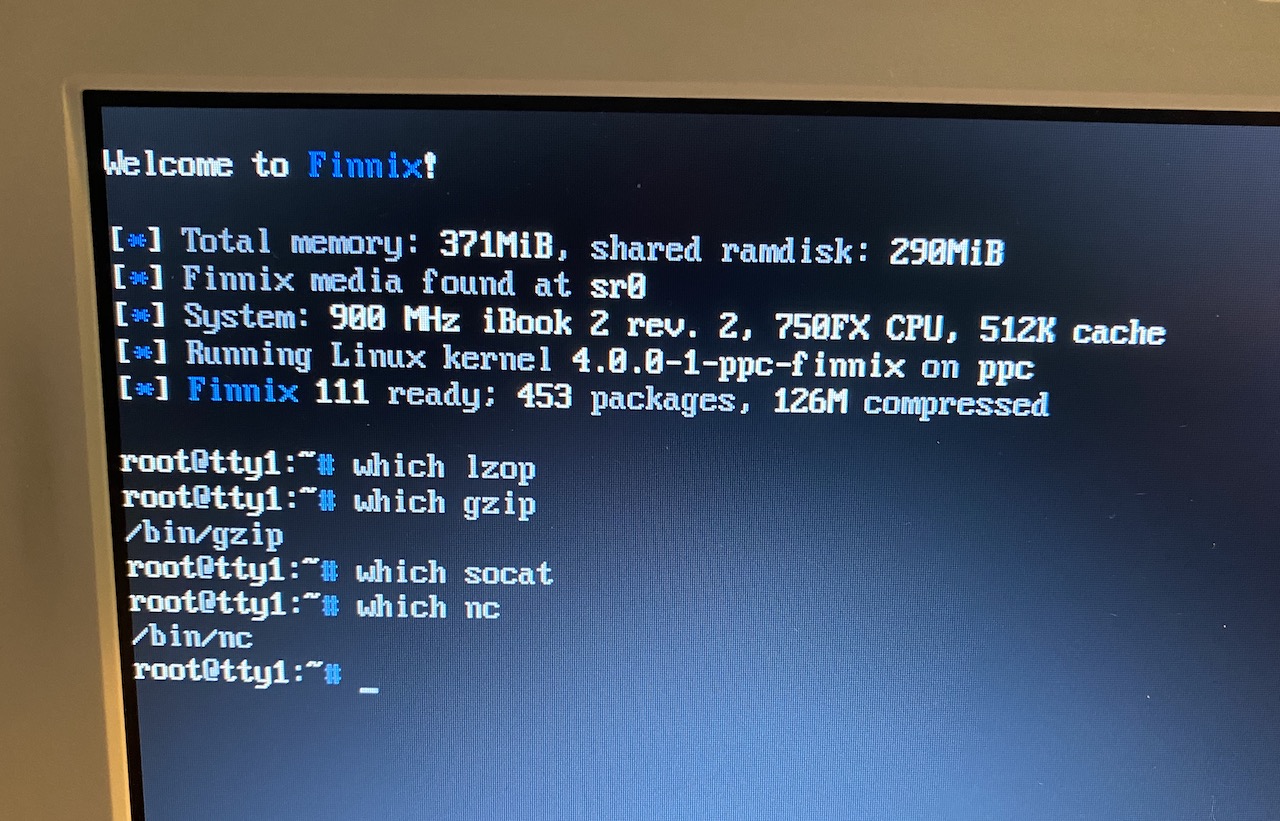

Ok, I just did a trial of this, using the Finnix Live CD finnix-111-ppc.iso (155MB) https://ftp.osuosl.org/pub/finnix/111/finnix-ppc-111.iso
EDIT: I made a remastered version of finnix which includes pv, socat, and lzop: https://forums.macrumors.com/threads/remastered-finnix-live-cd-with-pv-socat-lzop.2384155/
Finnix doesn't have socat, but it does have nc (netcat), which will also work, but doesn't automatically terminate the connection when the file transfer is complete (you'll have to wait until the transfer rate drops to zero and then use CTRL+c to kill it).
It also doesn't have lzop, which means we'll probably be limited to about 11MB/s by 100mbit ethernet.

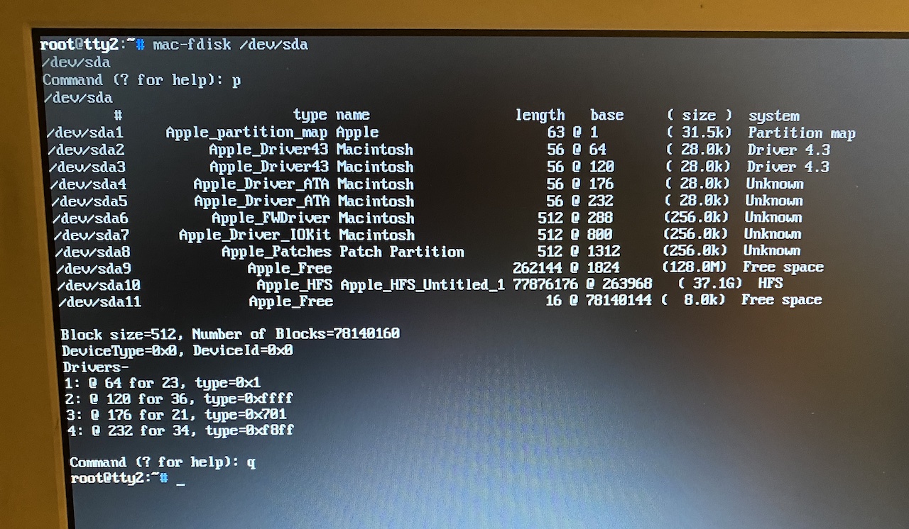

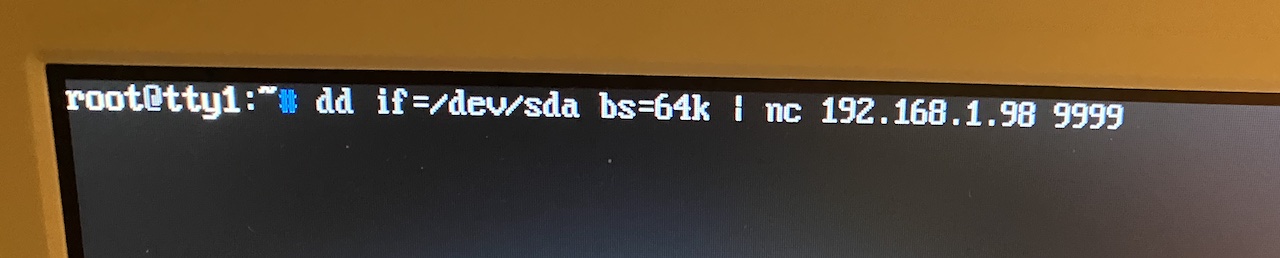

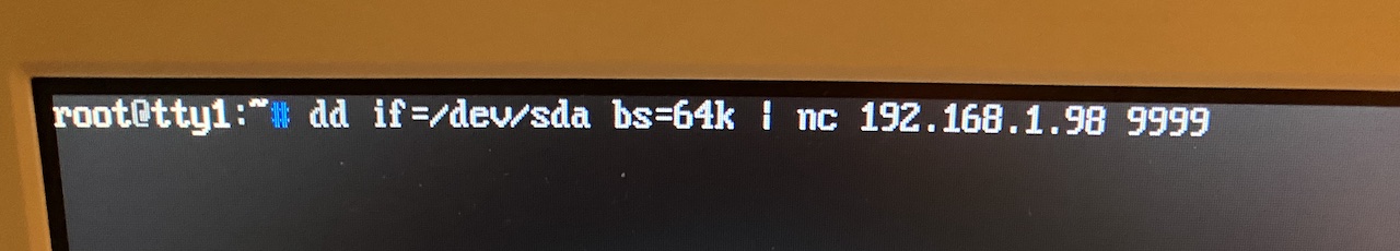

On the sending machine (the Mac being backed up, an iBook G3 in this case), boot Finnix, then use mac-fdisk to print the partition of the disk, just to be sure you have the right device name:
Then to send the backup, run:
Code:
dd if=/dev/sda bs=64k | nc 192.168.1.98 9999

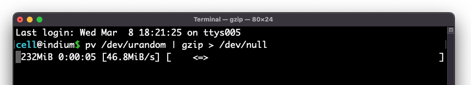

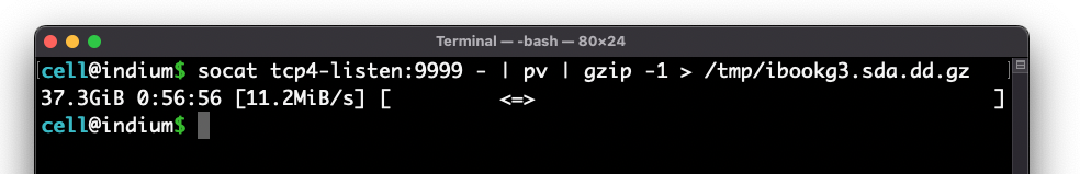

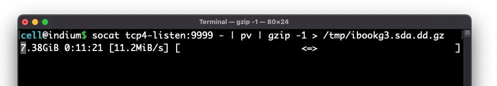

Also note that if the receiving machine is fast enough, you don't need to bother with gzip's `-1` flag. For example, my receiving machine is an M1 Mac Mini, which is fast enough that gzip's default setting exceeds the limits of 100mbit ethernet, so compression isn't the bottleneck (and I could just use `gzip` rather than `gzip -1`):

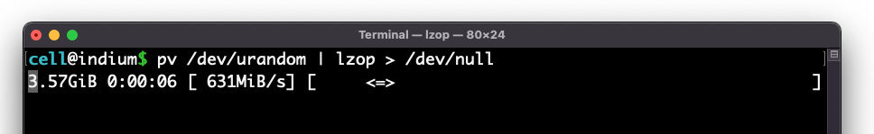

and just for comparison, here's how much faster lzop is!!!:

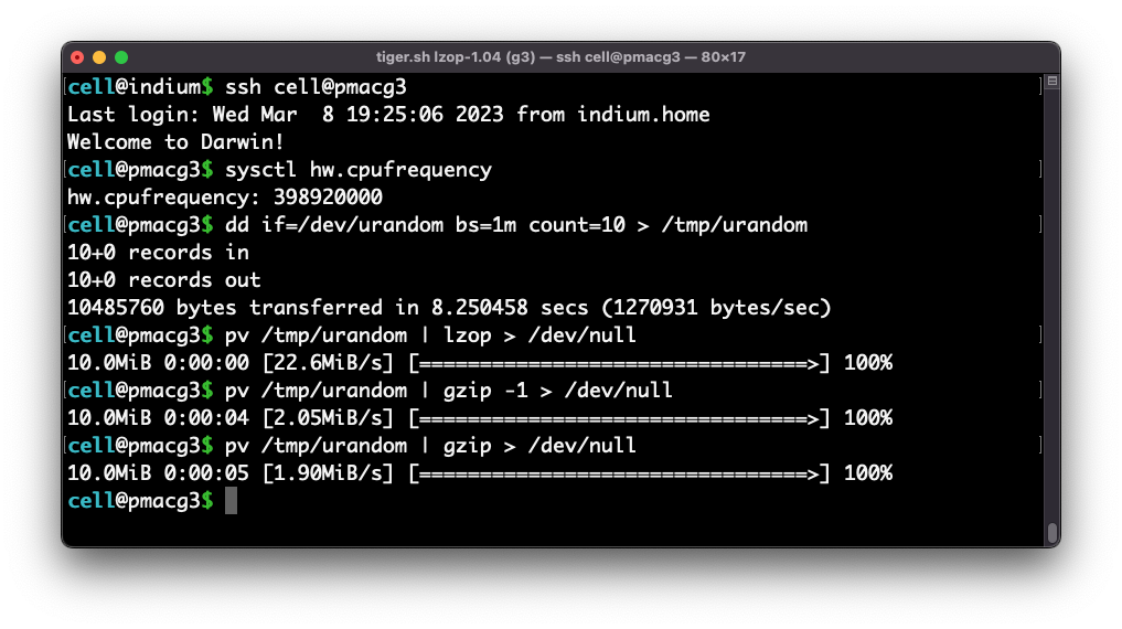

(It is likely that even a G3 Mac could sustain more than 11MB/s of lzop compression, meaning that you could use it on the sending side and speed up the transfer)
EDIT: indeed, even a 400MHz G3 can sustain 22MB/s of lzop compression:

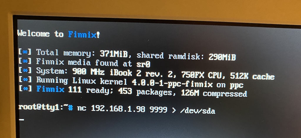

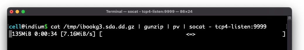

And to restore from that image:
On the sending Mac (my M1 Mac Mini, which has the backup image):
Code:
cat /tmp/ibookg3.sda.dd.gz | gunzip | pv | socat - tcp4-listen:9999
And on the receiving Mac (my iBook G3):
Code:
nc 192.168.1.98 9999 > /dev/sda
