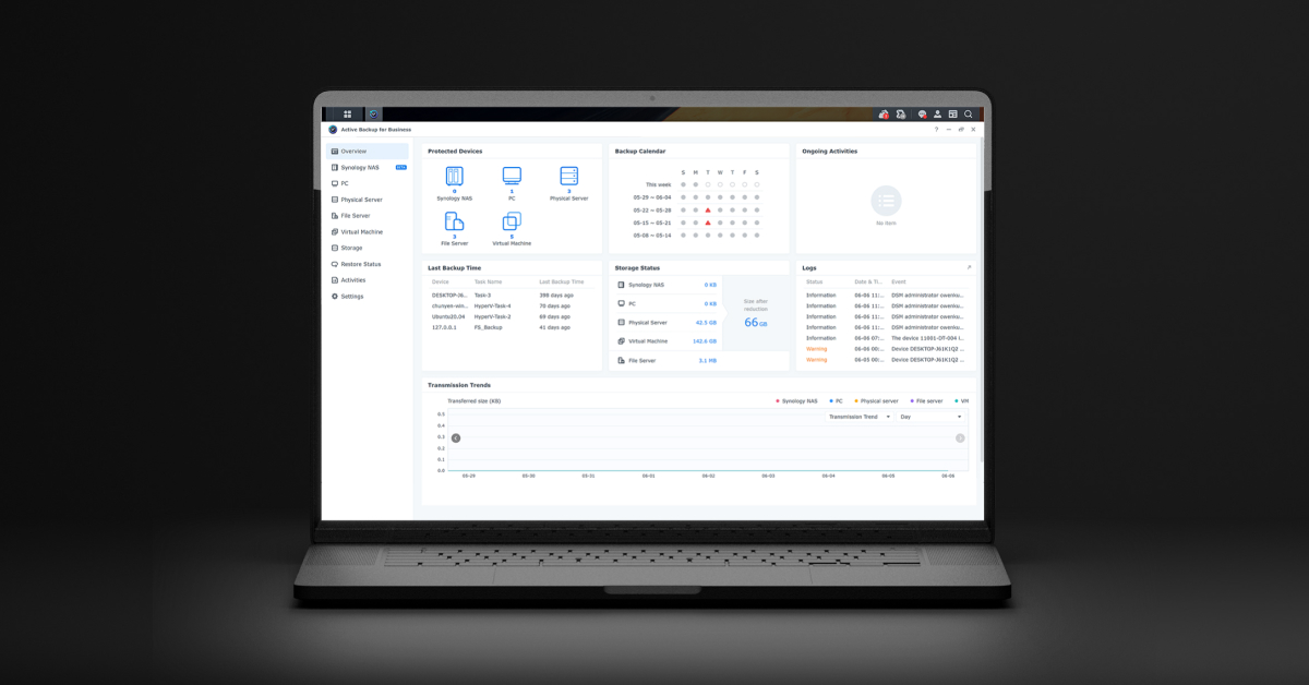

You can use Active Backup for Business as well.
Or you move the data to your NAS and use Synology Drive to replicate all data to local storage (this is what I do).
