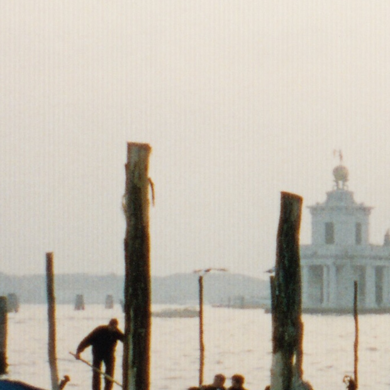

I thought maybe someone in this subforum might know what's going on here: my brand new Canon Lide 220 scanner is producing jpegs that look like this zoomed in:
You see the light vertical bands?
The source prints are glossy without texture. Resolution is set to 600dpi. The scanner is plugged into my laptop usb, only running on battery, so no external power to cause noise.
Any idea? Thanks!

Oops! Sorry. Have you tried increasing the scanning bit depth in the software?

Hmm, I don't see an option for that in the preset "Photo" mode I use, although it's set to high quality jpeg output.
I did some more research today, and it may be that the scanner needs to be recalibrated. I ran the "platen calibration" in Scangear, but I haven't had a chance to test again yet. I'm hoping the calibration is all saved in the scanner, so it applies even in Photo mode.

You mention on battery but have you also confirmed that it happens on external (wall) power as well?

... are the prints optically printed gelatin silver dye coupler prints or are they digital inkjet or dye-sub prints? Also, have you examined the prints with a high power loupe (~10-25x) to confirm that the banding is not an attribute of the print?
I've seen many digital prints that have very slight banding that is all but invisible to the naked eye but shows under high magnification. This could be the cause of your problem if the "originals" are digital prints. Even digitally printed gelatin silver dye coupler prints (e.g "Fuji Crystal" prints) can exhibit banding under high magnification, though it is much less likely.
Alternately, you could be encountering an alignment fault in the scanner or possibly the limit of the scanner's ability. I've seen the same type of banding in scans from a number of inexpensive scanners though I have no direct experinece with your particular Canon Lide scanner.
They are 30 year old prints.

[doublepost=1482619535][/doublepost]To the OP - what this print image stored in one of those albums that have those clear self sealing pages that are also tactile (holds the print somewhat in place)? Some of those types of albums have a not often noticed "ribbing" on the page and images stored on them can acquire that texture that might be somewhat exaggerated when a lighting source is at a given position. Though the latter is not likely to be the source, still worth checking out.
Also - have you tried rotating the pic 90 degrees to scan and see if you have similar results? There are several things you can check to see whether it is in fact your scanner or the print itself (and possibly both as combination). While you are at it, maybe attempt to scan with a different software or driver and see if the problem persists and of course, check to see if it happens to other scanned subjects.

I know this post is really old, but I have the same model scanner and came across your post. I resolved the issue by checking "Calibrate before each scan" in the Preview scanner interface. That cleaned up the lines instantly, and unchecking the calibrate setting did not result in the lines reappearing, at least not right away. Hope that helps.
