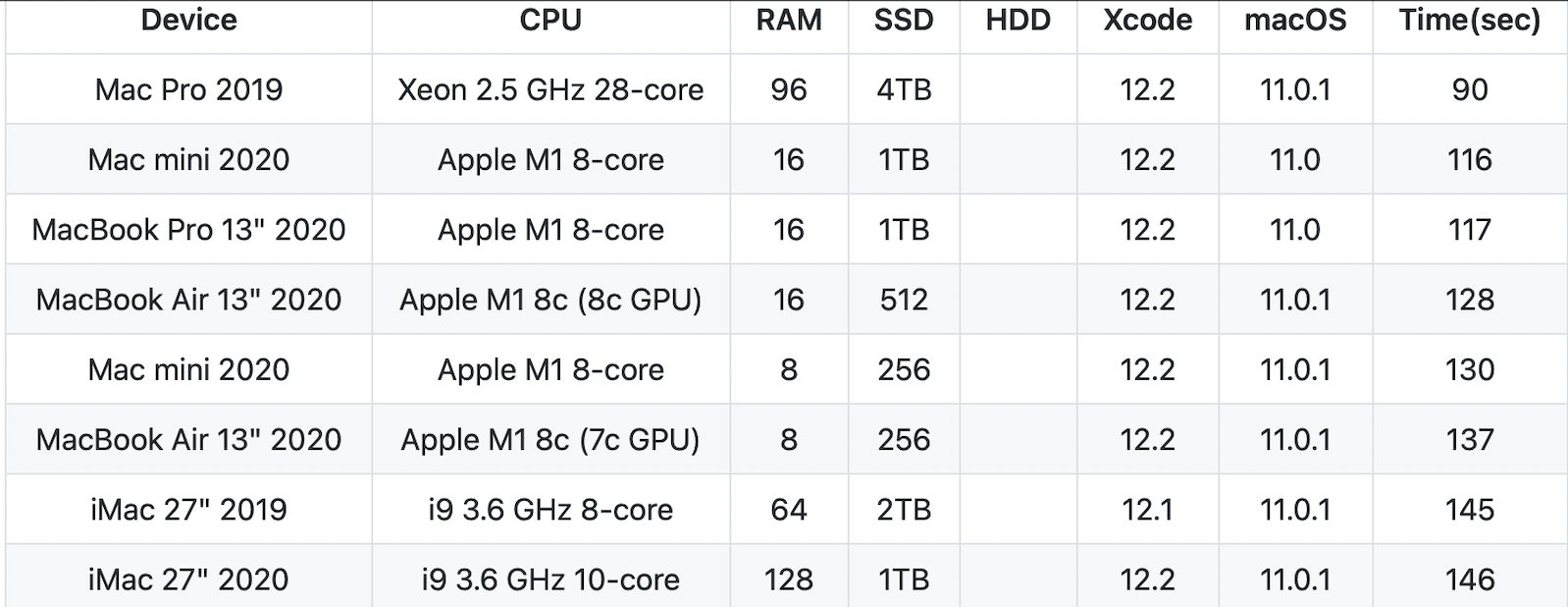

I'm planning to get an M1 Mini for Xcode development. I'm currently using a 2012 MBP with 16GB Ram and a 256GB SSD.
I had been thinking of getting 16GB and 512GB, but after reading so many comments about how 8GB on AS performs more like 16GB on Intel, I am starting to think about getting 8GB instead.
I know that there have been loads of benchmarks with all sorts of graphic and music related software, but the one that interests me most is the XcodeBenchmark on GitHub.
The £1300.00 Mac mini 16GB with a time of 116 seconds comes second only to a 2019 Mac Pro with 96MB RAM and a time of 96 seconds ! However the base model Mac mini 8GB is still amazingly fast at 130 seconds, faster than a 2019 iMac i9 8 core with 64GB RAM. That is more than fast enough for me !
My question is : will 8GB still be enough, running a 4K monitor and an Apple Thunderbolt monitor, with 2 Xcode projects open and 2 simulators running ?
I won't be running much else while using Xcode, apart from Safari with a couple of tabs open. I tend to close Xcode if if am using mail or using Handbrake, for example.
I'll be grateful to hear comments to help my choice !

Thanks - I have done, and on the basis of that alone I would go for 8GB.
However I wonder if the extra load on RAM by having two monitors attached, and running the simulator simultaneously (?) would make a noticeable difference.
