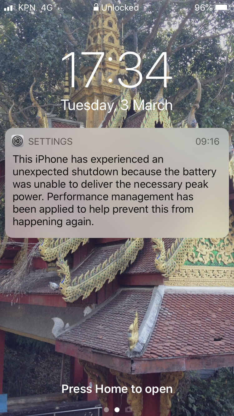

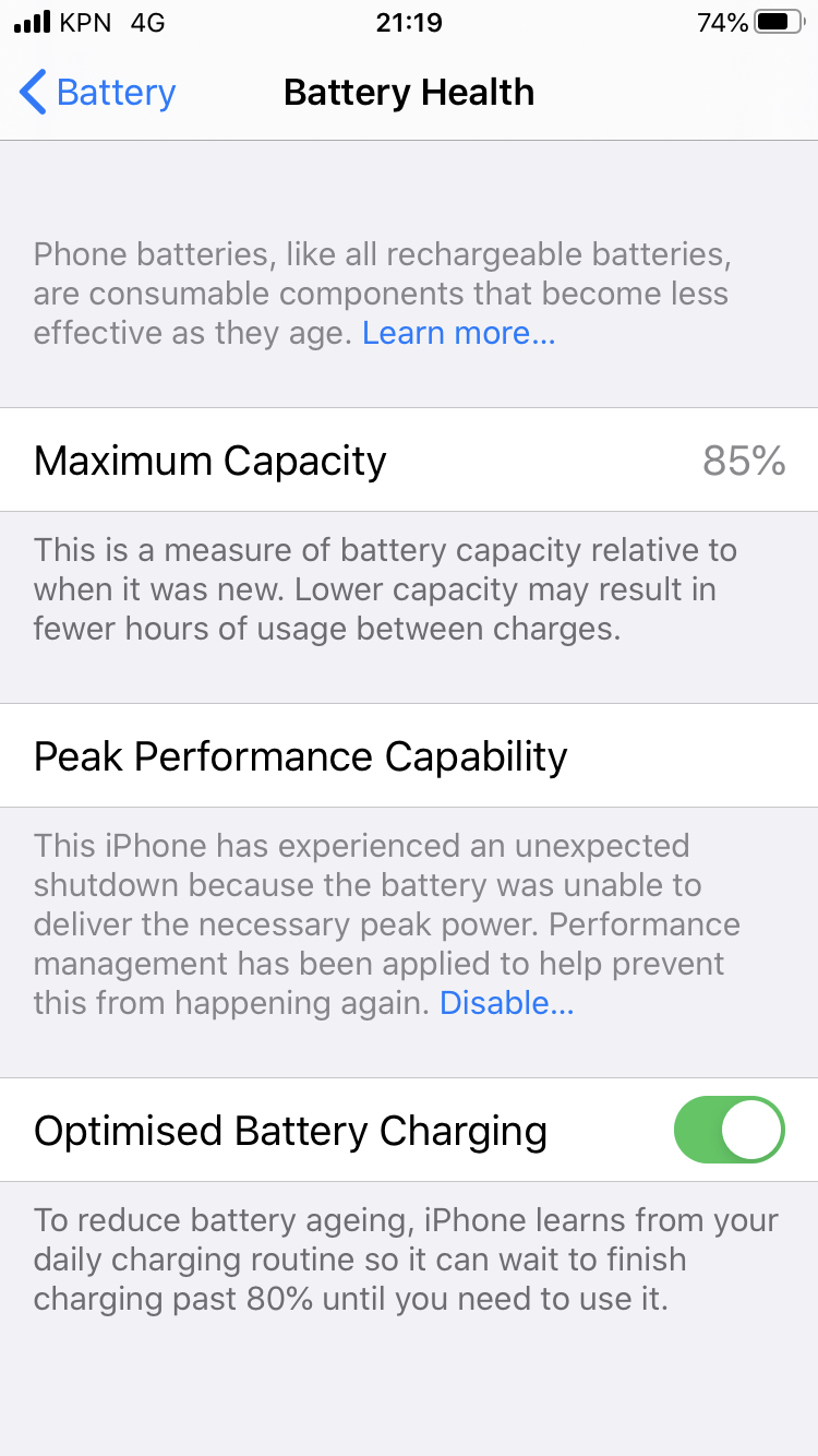

My iPhone 8, about 1-1/2 years old has issues : the battery cannot supply peak power
ans reboots if I receive a phonecall ( really, just a regular, GSM phonecall ),
even though the battery capacity is still 85 %. According to Li Ion battery specs, this should
only occur at capacity less than 30 to 35 %. Do I need to have the battery replaced, is
this the same issue as what happened to Samsung some time ago ?
Also, I have been using iPhone since model 4, never any problems, great product,
but this is a very unpleasant surprise. I was waiting for the new 12 but I'm not so sure
anymore.
I want to know if this is a one time fluke or if anyone else had this issue so I added
screenshots for comparison. Did anyone else have this issue ??

The Maximum Capacity % (85) doesn't take into count the peak performance the battery is capable of when cold. The battery is tired.
Either use the phone when it's warm or replace the battery or buy a new phone. Batteries don't last forever- especially if left plugged in over night.

It’s worn, 85% is an not exact so it could be far lower.

The 85% is an estimate. Realistically, users should consider replacing once it drops below 90%. By 80%, the battery is extremely unreliable.

As the battery accumulates wear from use/abuse the internal resistance of the battery increases which restricts the flow of electricity. There is a predefined shut off voltage when the battery is low and voltage should indicate 0% on the battery gauge. When you put a heavy load on a battery the voltage drops if there is a high internal resistance the voltage can dip way down and in your case it dipped because the shut off voltage. Its like starting a car with a weak battery and the dome light dimming severely.
Typically the battery health is lower then that when you experience premature shut downs.
High voltage at high temperatures is what typically causes high internal resistance more quickly. Like leaving the phone in a car on a hot summer day, or even worse have it charging in a car on a hot summer day. Or suction cupping it to the windshield, plugging it in and using the GPS when its hot. This causes a specific film that I can't remember the name of to build up on the anode and cathode of the battery. This is why window mounted GPS's battery don't typically last more then 6 months before you can notice the massive decrease in battery life.
There is plenty of science with batteries but to many variables to really worry about it. 500 battery cycles is assuming you are charging to 4.2volt (100%). Few mV lower and 700-1000 cycles is possible. This is why EV's can warranty batteries for 8 years, they aren't over charging them.

They do "allow" replacements. If you ask for a new battery and pay for it out of pocket, they will do it. The difference is whether they are going to replace it at no charge during the warranty period. For that, they want evidence of "defect," and 90% within the first year of use is not defective, it's normal wear-and-tear. For a free replacement at 90%, they'd have to build the price of replacing nearly every battery into the original price of the phone.
Further, once people have an expectation that 90% is the "replace" point... well, environmentally it's not great. The environmental cost of replacing batteries after one year rather than two is pretty substantial.
I'm sympathetic to Apple agreeing to replace at 85% if it is accompanied by a history of peak performance shut-downs. The ability to charge to 85% of original capacity does not necessarily mean that it can also deliver adequate peak current - steady-state charge and "cold cranking power" (as they say of car batteries) are two different properties of a battery. Batteries do age, and those two characteristics do not necessarily age at the same rate - the way a battery is used helps determine how it ages.
Still, in the case of the OP, there has been one unexpected shutdown. The OP has a choice of leaving "throttling" engaged and getting more life from the battery, or replacing an aging battery in order to maintain peak performance.
