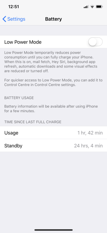

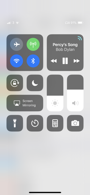

I just did a reset all settings instead of a factory reset. Taken off charge 6 hours ago, on airplane mode and still at 100%. That's more like it.
Reactions: Newtons Apple
airplane mode shuts off external communications and doesn't shut down all functions. So you could have a game doing graphics and motion stuff still in AirPlane mode
It lost 1% in 22 hours or so in airplane mode..happy with it again. I've been browsing and listening to music for an hour and 40 minutes. Resetting all settings seems to have been the cure.
