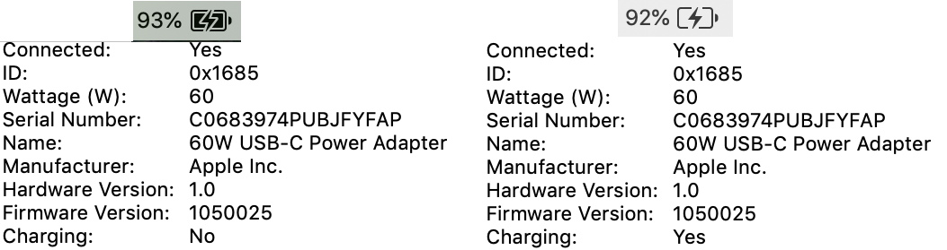

thanks for the link - just so i understand - are you saying that it's intended behavior to have the laptop plugged in and it not charge? That's what was happing, it would say "Not Charging" while plugged in and the battery would drain per normal.
Yes, the battery will periodically stop charging and discharge some, and then resume charging again automatically.
