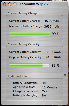

I think the best thing you can do for a battery is to use it. If you let your laptop sit on a desk for extended periods of time without using the battery, you'll lose maximum capacity. On my 15 month old ibook, I have 380 loadcycles, and it still has 83% maximum capacity... I routinely run the battery down just about every day. So, in essence, it is calibrated mutilple times a week, since I run the battery down fully, then just plug it in overnight so it recharges fully in the sleep state. Anyways, heres the coconut battery screen shot:
