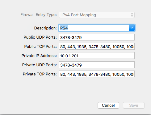

AEBS Set as, based on what I have already googled but this may be wrong.
Public UDP: 3478-3479
Public TCP: 80, 443, 1935, 3478-3480, 10050, 10051, 10040-10060
Private IP: 10.0.1.201
Private UDP: 3478-3479
Private TCP: 80, 443, 1935, 3478-3480, 10050, 10051, 10040-10060

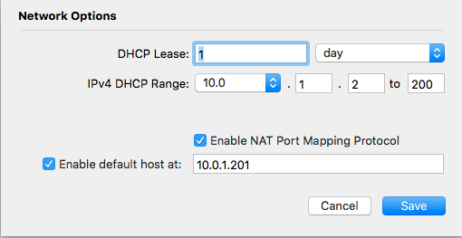

Then I have "Network Options" set as:

With "Enable default host..." checked like that, you are putting the PS4 in the DMZ and effectively bypassing the router, so you don't need to open those ports in the top screenshot. With the device in the DMZ, it is exposed directly to the Internet and all those ports will be open.
I had a Time Capsule (same as Extreme both with a hard drive inside) I used with my Xbox One and used that DMZ setting and always for Open NAT and never had any troubles.
Thanks for your post-
It looks like I have it setup correctly? If so, I have a different issue that is causing issues. I cannot download a single game without "Cannot Download" errors every few minutes. I tried resolving the issue by setting up port forwarding but it does not seem to resolve that issue. I thought maybe a firewall issue but I thought port forwarding would have helped that as well.

Yes... with it in the DMZ like that, your router would not be blocking anything and should not be the issue. I think you have something else going on.
Time Warner is likely the issue since they are impossible to deal with to resolve issues with their service if that is the case. They are less than excited to help when you buy your own modem (Arris/Motorola Surfboard... only configured by ISP). Haha
