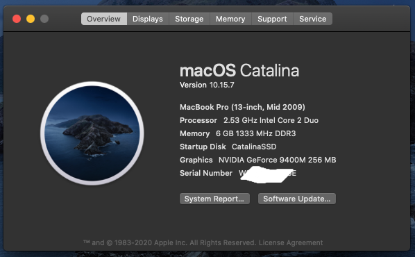

Thanks. It is turning out to be a nice browser. I'm still working on some UI refinements, and the UXP back end its built on is really quite impressive seeing as it was originally forked from FF52. I haven't run in to a site yet that it doesn't handle (that doesn't require webrtc/eme, e.g: widevine).
And.. I'm also using the dosdude catalina patcher on a 2009 MBP. With the old HDD swapped for an SSD it runs very well.
