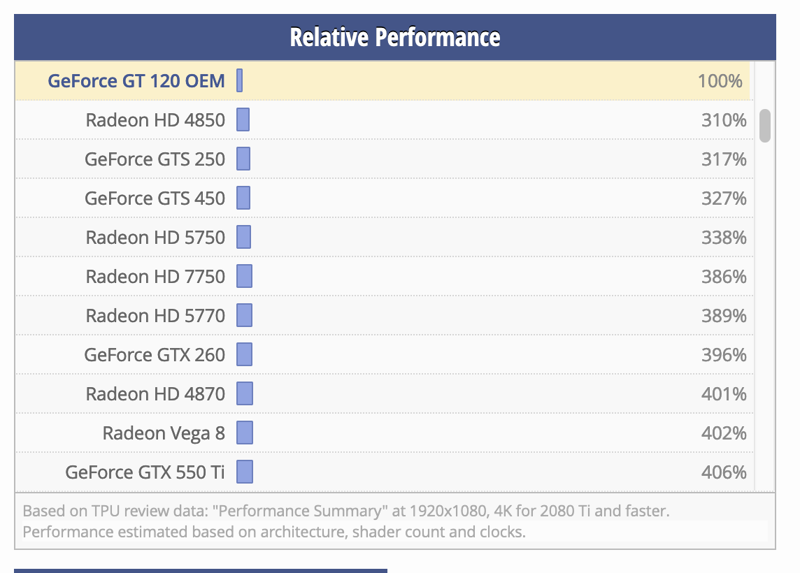

Seems you made a mistake, the reference used a RPI that is relative to ATI HD 7970 (GPU used as reference, the 100% GPU), you didn't understood the index, lower scores = weaker performace.
NVIDIA GT120 was the basic GPU for early-2009, ATI Radeon HD 4870 was the top performance model of the same early-2009 Mac Pro.
ATI Radeon HD 4870 performance is around 401% of a GT120. See TechPowerUp charts where is easier to understood the performance:
No, I didn't misunderstand how the chart works, I made a mistake on which card I was looking at 😂 you are correct the one I have outperforms the GT 120 a lot.
