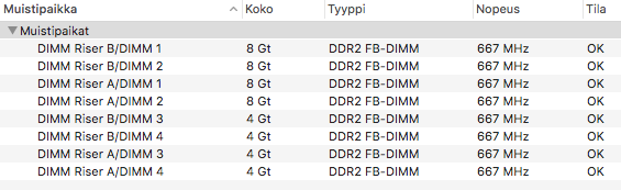

Heatsinks are under debate which ones are better for cooling (maybe you want to try search within Mac Pro forum). I chose to keep the flat ones I bought. I do have bigger ones too, but I don't think it's worth the hassle changing them.
First I had some trouble to get dimms recognized, but with trial and error I got all of them working, 48 GB. Please see pic. I chose 667 MHz because 800 MHz was many times the price of these slower ones.
I bought 8 pcs and the other half is in my 1,1 (flashed to 2,1). It sees max. 40 GB though, and I have no idea why.
Risers A and B are both populated the same way:
slot 1: 8 GB
slot 2: 8 GB
slot 3: 4 GB
slot 4: 4 GB
These tend to get a little hot, but that's normal behavior for FB-DIMMs I have understood.

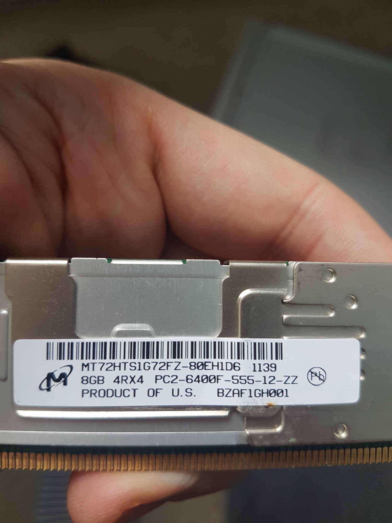

Thanks all. Now all my RAM has arrived, but I have a strange issue.
No matter what combination I try it (the server RAM on its own, or together with some of the 'fat' Kingston RAM), the RAM only runs at 667 Mhz. It is definitely PC2-6400F RAM though. This does not occur with the 'fat' Kingston RAM only. What could cause the Mac Pro to down clock 800Mhz RAM to 667Mhz?
I have tried inserting each of the risers separately with only 2 sticks of RAM, and it is still only seen as 667Mhz. I am resetting the PRAM every time I change the RAM.
Just to clarify, I am not mixing any frequencies - all the RAM should be PC2-6400F 800Mhz RAM.
All the sticks are like this:
4R4 is the wrong type
a cMP wants 2R4
****. Ok thank you. I had no idea - I guess I took a gamble on this server ram but it didn't pay out. Is the 4R4 what causes the RAM to downclock then? Is there any way to make the RAM run at 800Mhz, or should I just sell it and get different modules?
due to it being 4r4 it will only do 667 in the cMP, that being said most would say having more ram is better than faster ram and you'll probably never see the difference outside of a synthetic benchmark.

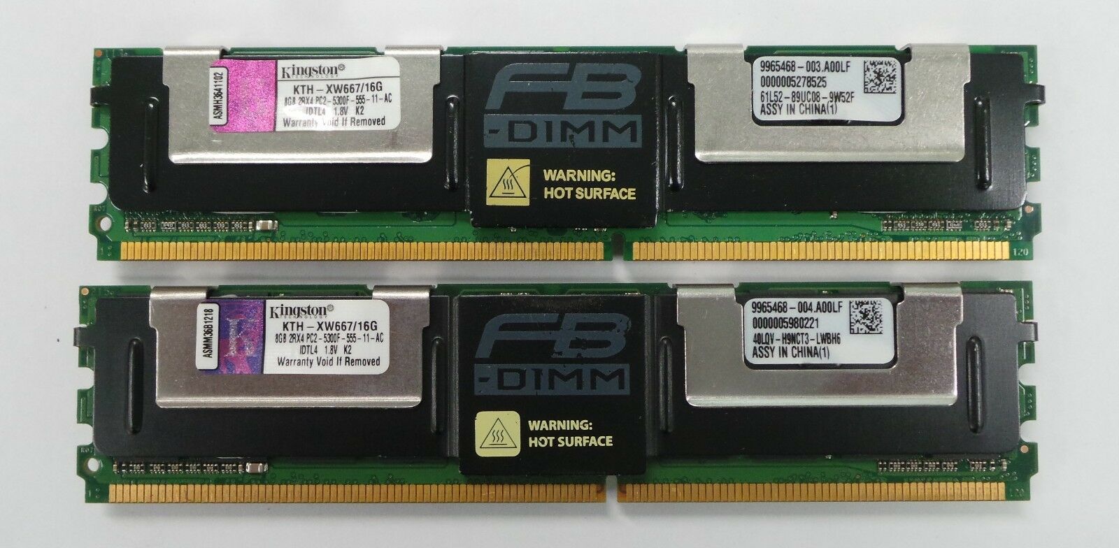

I don't think the RAM was bad - I tried all the sticks separately and they worked. It was just when all were installed that it didn't boot. I am now leaning towards the option of installing 56GB of PC2-5300F RAM, maybe something like the picture below. It has Cas Latency 5.

The reason why I was suggestion to keep by FB-800 sticks is not because of the frequency - I know they will downclock to FB-667 - but because they have the big fat Apple-recommended heatsinks. So I thought it is less likely to burn!
But then again, FB-667 memory runs less hot than FB-800, so perhaps what I should do is just sell my RAM (which still commands a premium) and get cheaper server FB-667. This Kingston RAM below looks like it has marginally better cooling than most of the server modules, which look to have cheap slabs of metal and that's it. Anyone have experience of this?
