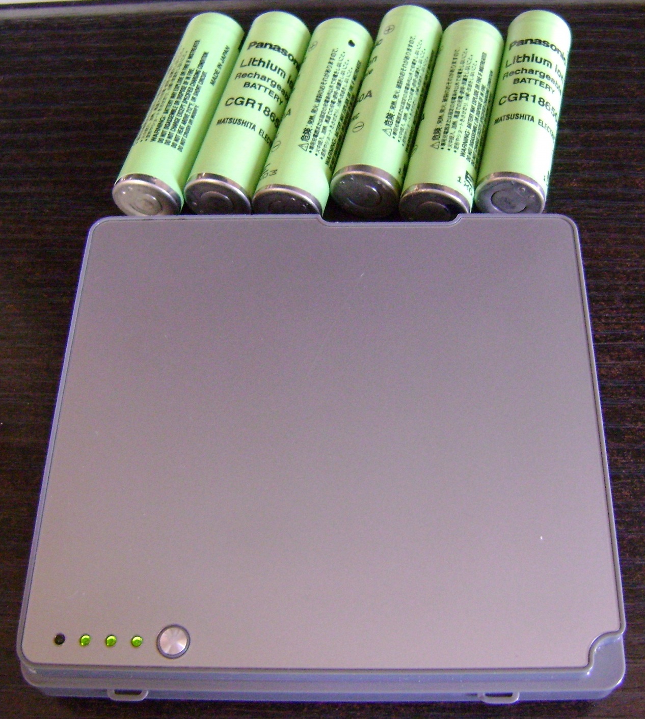

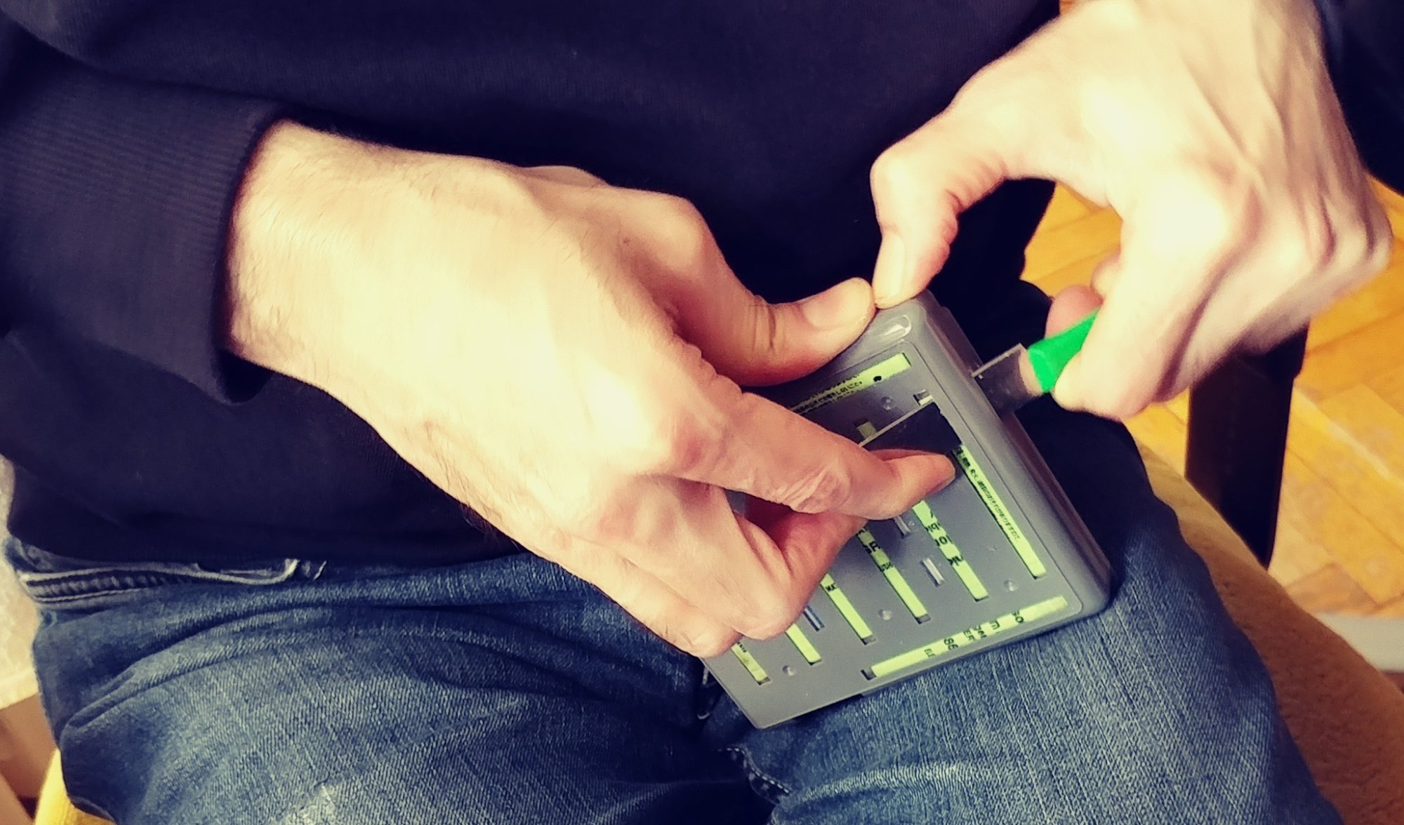

I had two of those batteries. Last year I pried open one of them which didn't hold any charge at all:
and took all 7 Lithium Ion batteries out: (6 pictured here, one of them was leaking so I threw it away)
The one you see below is functioning quite good. It can power my PowerBook 1GHz for an hour or two (didn't do any special measurement) Considering that it was manufactured in 2002, it's fantastic. I don't do anything out of the ordinary to preserve its life. I just remove it from the TiBook when I won't be using it for extended periods and store it in a cool, dry place.
Just in case you pry the battery open for the purpose of replacing the 7 Li-Ion batteries:
Be sure to watch any video (if there are any) showing how to pry open the bottom plastic case without damaging the mini-board inside and particularly the ribbon cable connected to mini-board. As I pried it open, I damaged the ribbon cable inside. I could have repaired it but didn't want to mess with it because I already had a one healthy, functioning battery. If it was the only battery I had, that could have been a big problem.
