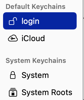

Here are the four categories in Keychain Access (see screenshot).
Which of these corresponds to what's contained in the *.keychain-db files?
And what about the System Keychains?
System contains my wifi passwords.
System Roots contains some external passwords, like Amazon and others.
