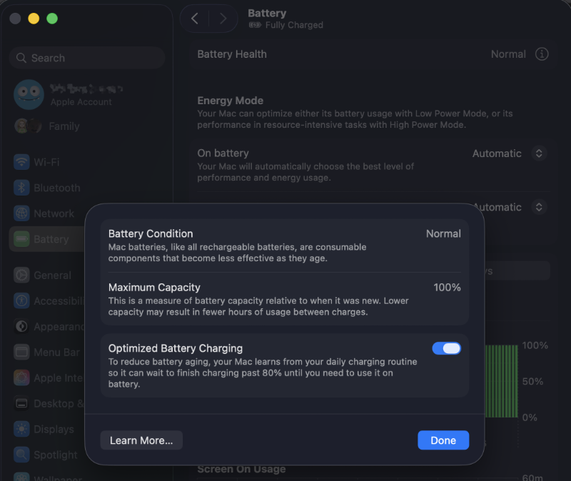

Your Air M2 once it's at 100% isn't charging the battery, Apple has very good battery management to protect your battery when plugged in all day. You don't need Amphetamine you can use what's in settings to stop your laptop from going to sleep.

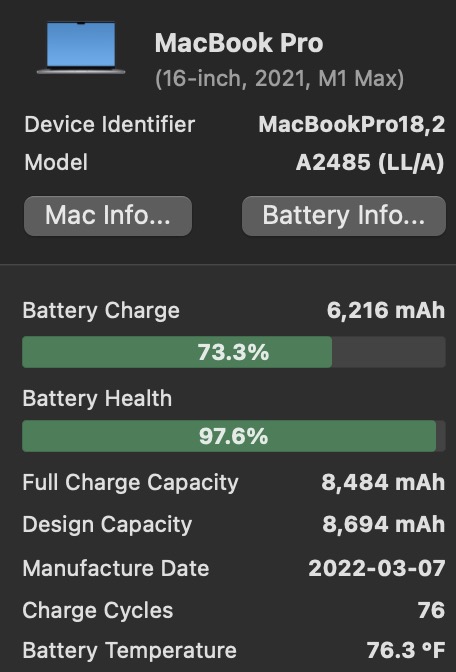

I use AlDente to keep my MacBook charged to 50-60-70% and it's done pretty well for my 2021 16' MBP : - I use it 100% in clamshell mode with an external display (used to travel more for work so a laptop was necessary).

My M4Pro16 has been in clamshell mode since November of 2024. The only time I remove it from the stand is for travel. I keep it plugged into a monitor via USB-C cable and have not turned it off ( or even remember restarting it ) since I purchased it. Apple's power management handles everything. Keyboard and trackpad are plugged into the monitor as well. The monitor is plugged into the wall outlet.
