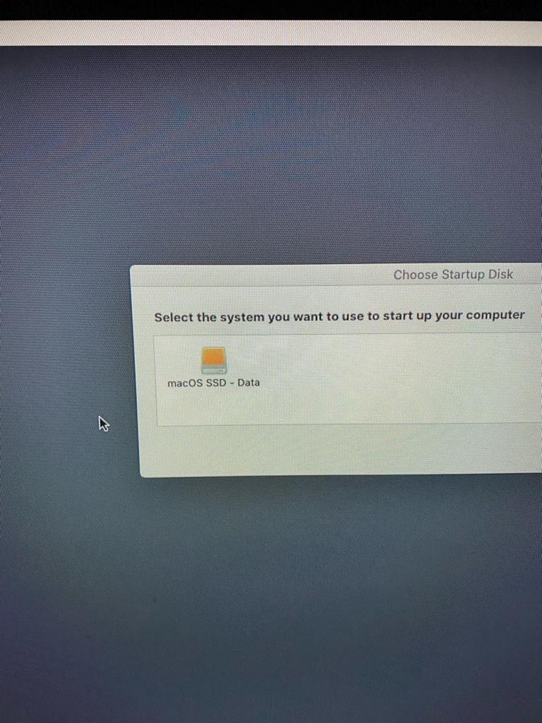

So I have upgraded my Catalina installation on my external T5 SSD to Big Sur and now the installation on the drive is not recognized in startup manager.
It appears in the recovery Startup Disk utility but it gives me an error if I try to select it.
Any help?

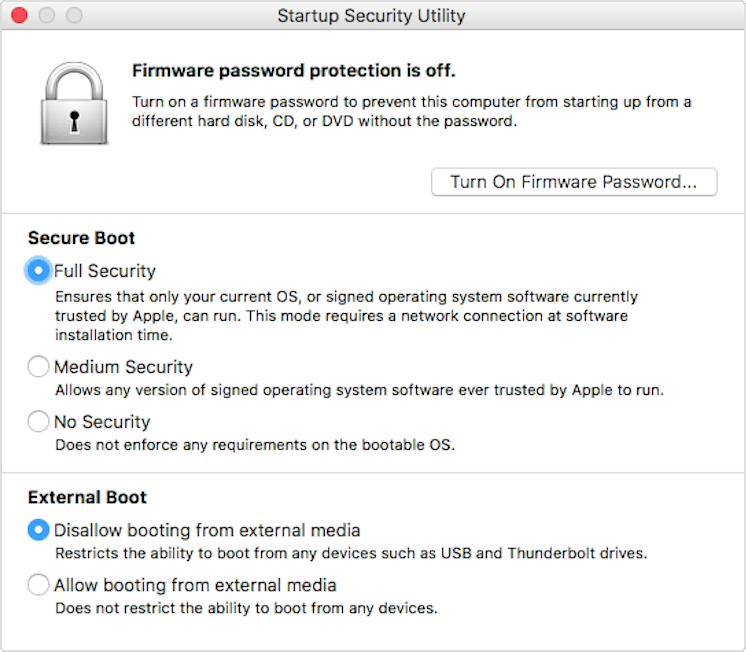

if you have a Mac with T2 chip, Apple has given some steps which can be found below:
https://support.apple.com/en-in/HT208198
Exapanding on that:
Open Startup Security Utility​
  1. Turn on your Mac, then press and hold Command (⌘)-R immediately after you see the Apple logo. Your Mac starts up from macOS Recovery.
  2. When you're asked to select a user you know the password for, select the user, click Next, then enter their administrator password.
  3. When you see the macOS utilities window, choose Utilities > Startup Security Utility from the menu bar.
  4. When you're asked to authenticate, click Enter macOS Password, then choose an administrator account and enter its password.
Change External Boot settings​
Use this feature to control whether your Mac can start up from an external hard drive, thumb drive, or other external media. The default and most secure setting is ”Disallow booting from external media.” When this setting is selected, your Mac can't be made to start up from any external media. Attempting to do so will cause your Mac to display a message that your security settings do not allow this Mac to use an external startup disk.
To allow your Mac to use an external startup disk:
  1. Open Startup Security Utility.
  2. Select ”Allow booting from external media.”
    Your Mac doesn't support booting from network volumes, whether or not you allow booting from external media.
  3. If you want to select an external startup disk before restarting your Mac, quit Startup Security Utility, then choose Apple menu  > Startup Disk.
Note:
I would leave the Secure Boot option as it is and only make changes to external boot settings.

"The bless tool was unable to set the current boot disk" is the error that I am getting.

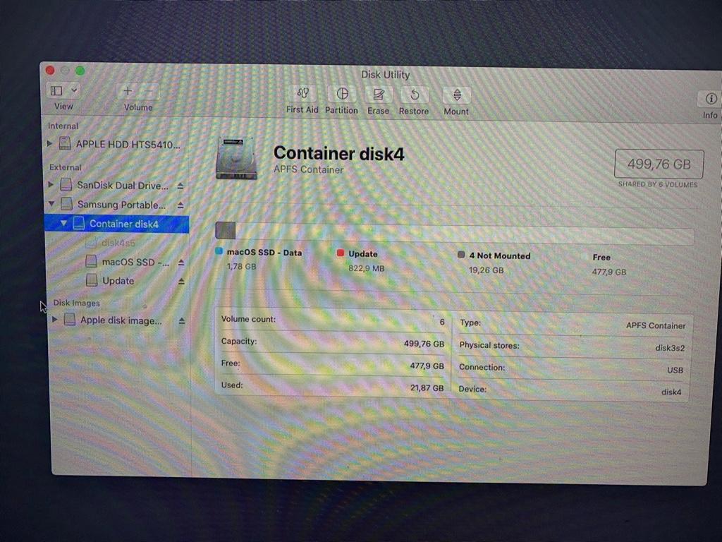

Here's a picture of the Disk Utility.
On Catalina I had the SSD with one container and 2 parts (macOS SSD/macOS Data)
Now I have 3 parts (?)
And the bootable section is gone from startup as well
