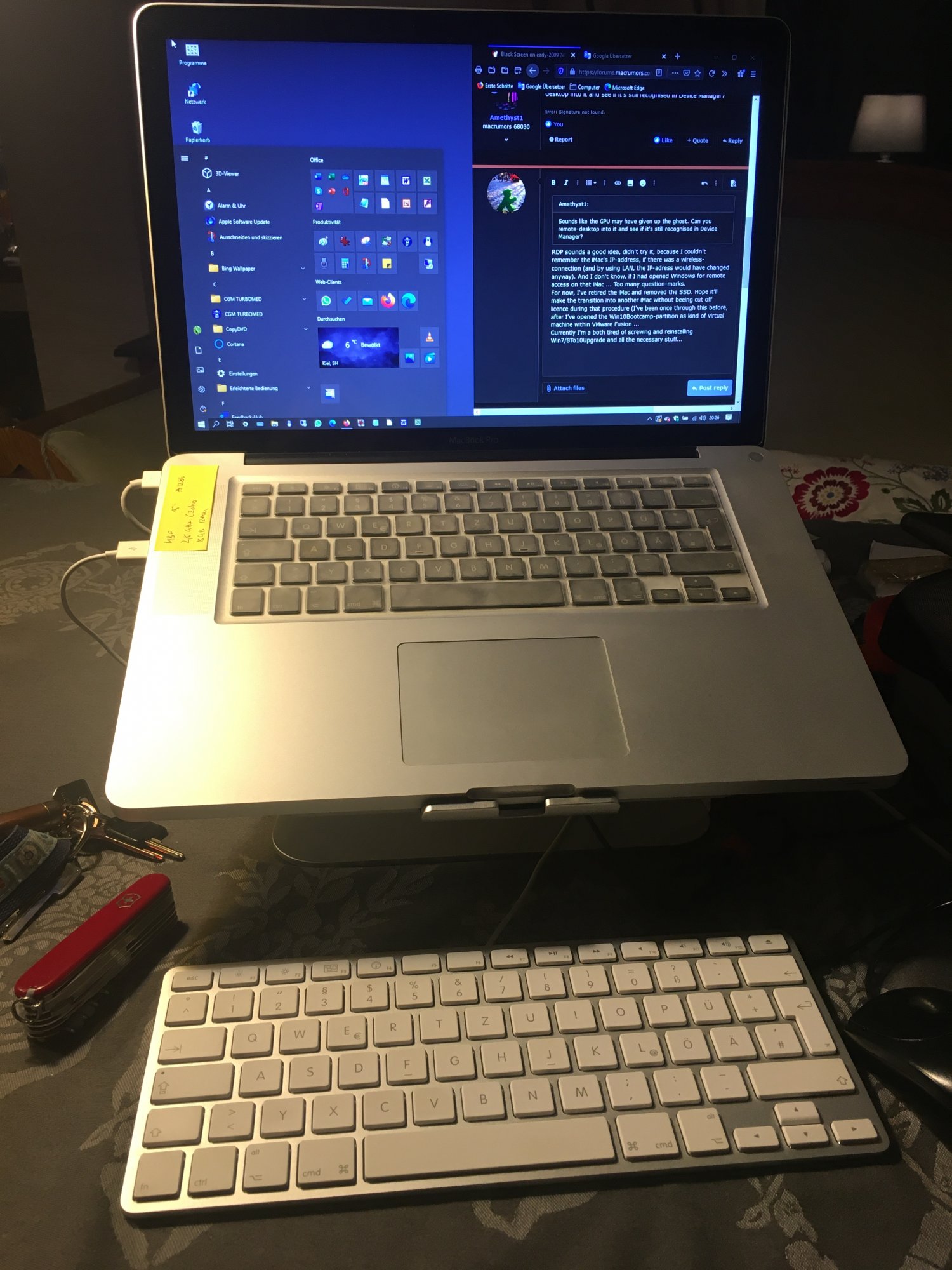

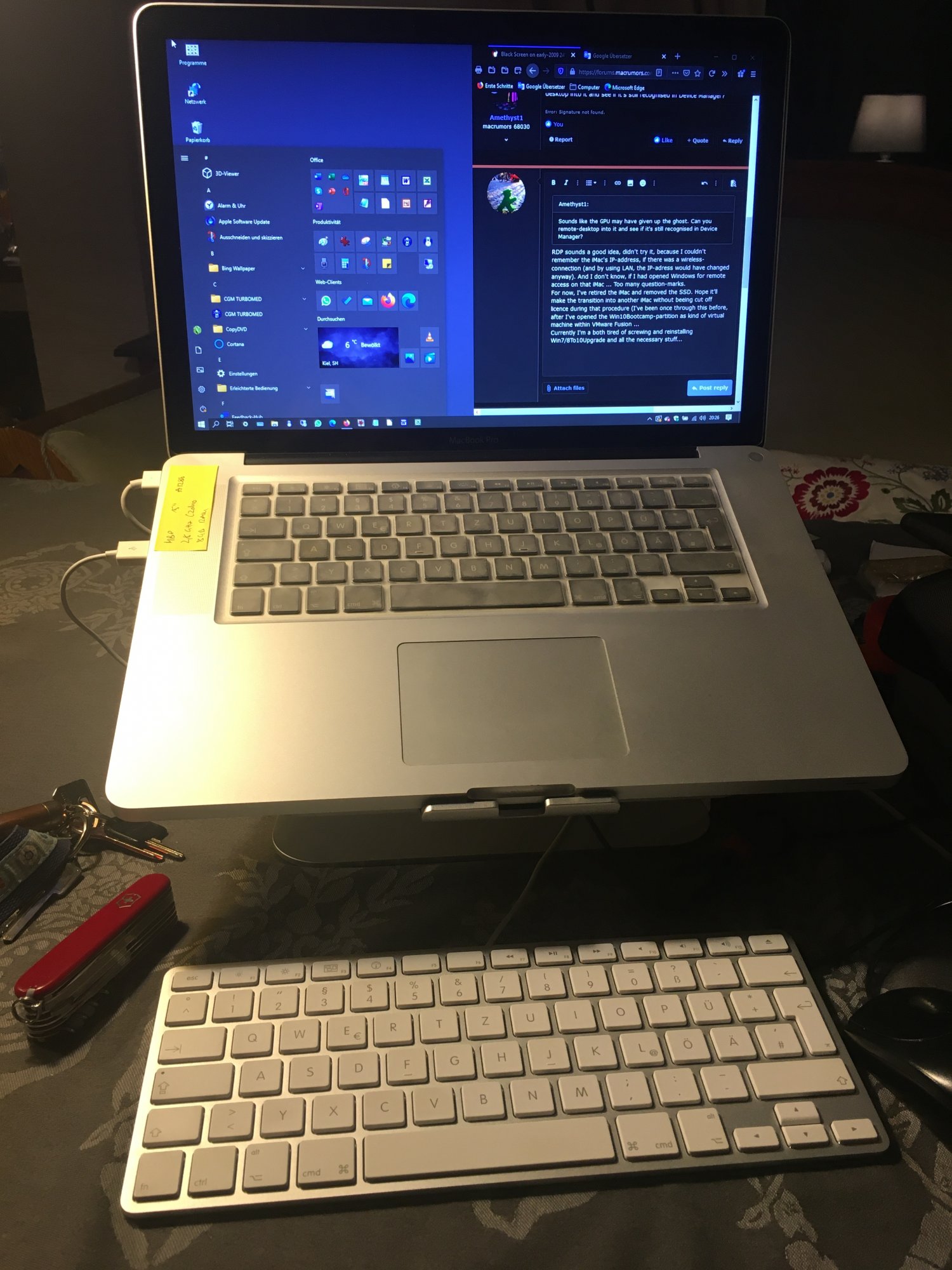

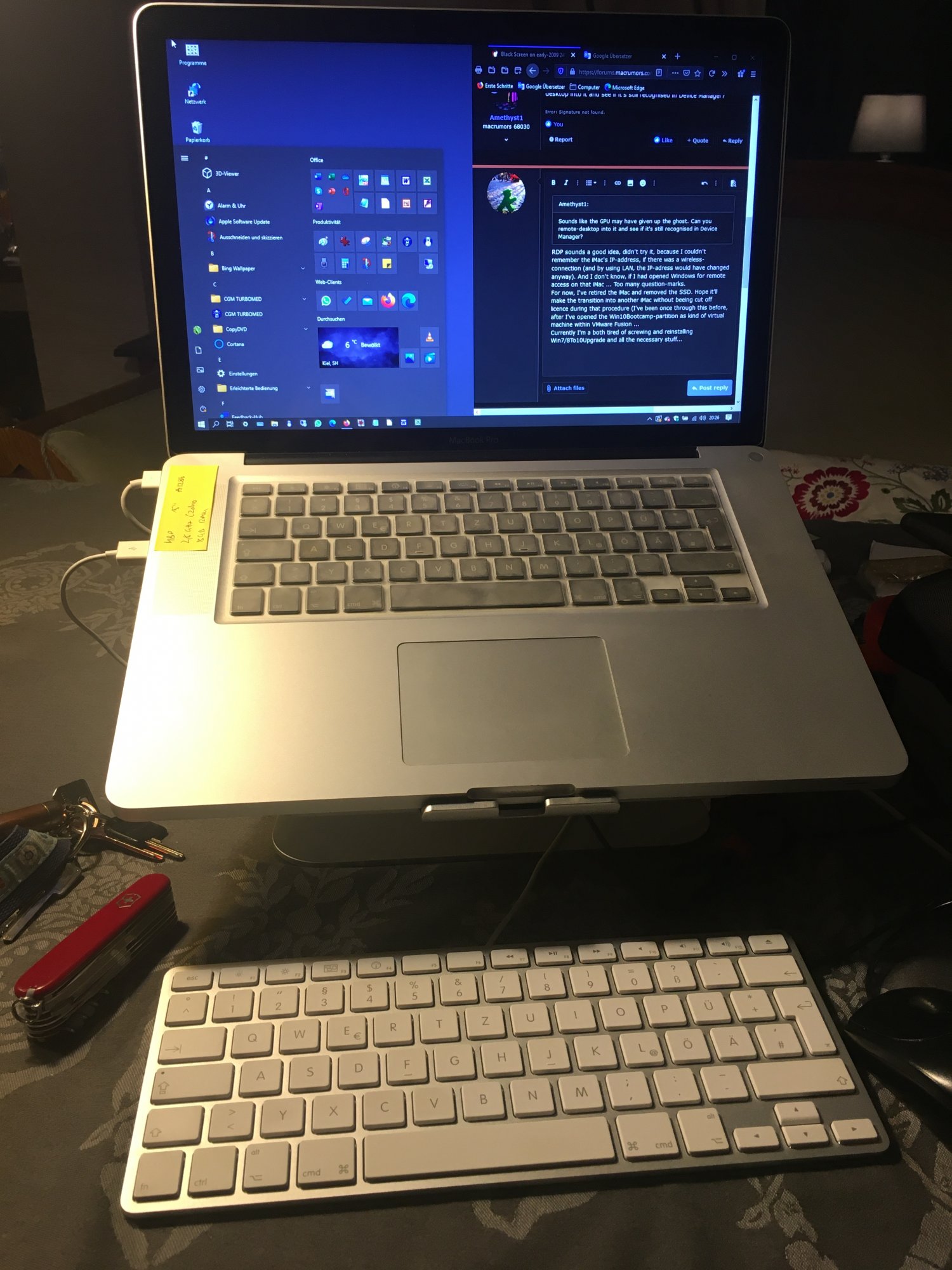

Until the real thing comes along, substitute will be this c2d MBP from 2009, sitting on an mStand, attached with USB-keyboard/TPU-cover and USB-mouse (to keep the MBP clean from sticky fingers as a result of desinfectant and skin-care).
