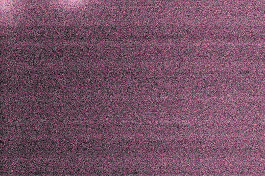

I just did some non-scientific "testing" with a nikon d40.
Both shots are 30 second exposures at ISO1600. Both shots have +10 stops of exposure and -0.1 offset applied in photoshop. that makes them ultra unrealistic high iso1638400.
first image: lens cap on, camera under thick blanket => absolutely no light.
second image: lens cap on, camera on table, bright fluorescent lamp directly at viewfinder.
Observations: the two "bright" areas in the upper left corner are amp-glow. Those are normal.
The horizontal bands are normal too.
The second image has one "bright" area in the center right that could result from the light source. In general number 2 is "brighter"
Of course, since I only took 2 exposures, this "result" could be a normal sensor data variation.
