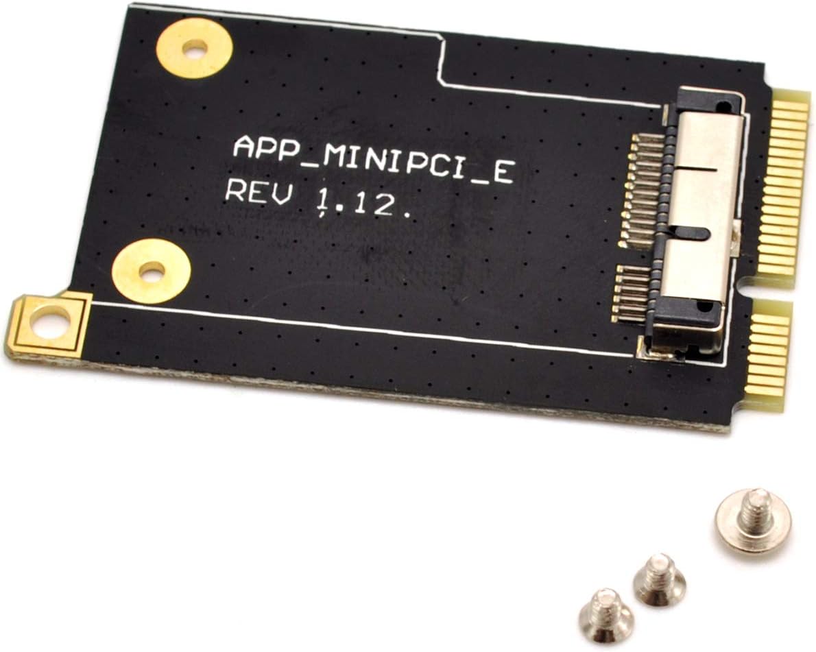

Not sure if this is still the case, but when I originally started using OCLP on my 3,1 a couple years ago, I believe the correct procedure was to remove the original Bluetooth card as mentioned to prevent panics. In order to have working Bluetooth you needed to then get a get a combo WiFi/Bluetooth card to replace the original WiFi card).
If that is still the route to go, you'll need two things – a compatible WiFi/BT card and a 52-Pin Mini PCI-E Express Adapter (which the WiFi/BT card is installed onto). The WiFi/BT card I chose was Apple part number 653-0014. I believe it uses the Broadcom BCM94360CD chip.
The mini PCI-E adapter I used is no longer available from where I got it, but here's what the description was – "Deal4GO Mini PCI-E Express Adapter Converter 52-Pin Mini PCI-E Card for Broadcom BCM94360CD BCM943602CS BCM94360CS2 BCM94331CD BCM943224P". (See photo of adapter attached).
Note that there used to be two kinds of mini PCI-E cards for this. Note that you DO NOT need the card that includes a USB data cable. That version is for 4,1 and 5,1 machines.
There are instructions/videos out there that you can search for. Pretty simple except for how difficult it can be to snap the antenna wires to the card. There were also some varying suggestions on which is the correct port on the card to attach the Bluetooth antenna to, so maybe look for multiple sources on that.
Although all that said, if the WiFi card was already updated to a WiFi/BT one, and the old Bluetooth card is still installed, maybe the problem is just a conflict between the two and removing the original BT card will cure the issue.
And, finally, before I decided to put the WiFi/BT card in, I considered just using a USB Bluetooth adapter. Supposedly the Hideez adapter is compatible with newer versions of MacOS, but you'd want to confirm that yourself.
