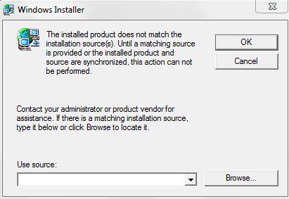

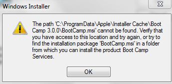

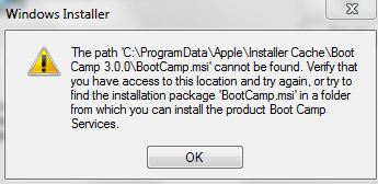

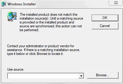

I'm having similar problems. I'm on a late 2006 black Macbook C2D with Windows 7 32-bit. I've been running Boot Camp 3.0 without problems, but the 3.1 installer won't work (see attached pics). I reinstalled BC 3.0 from the SL disc and tried 3.1 after that too.
