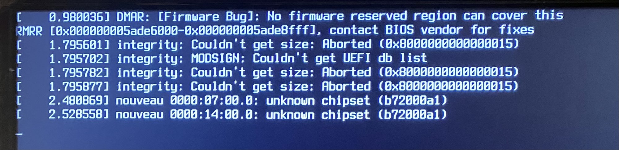

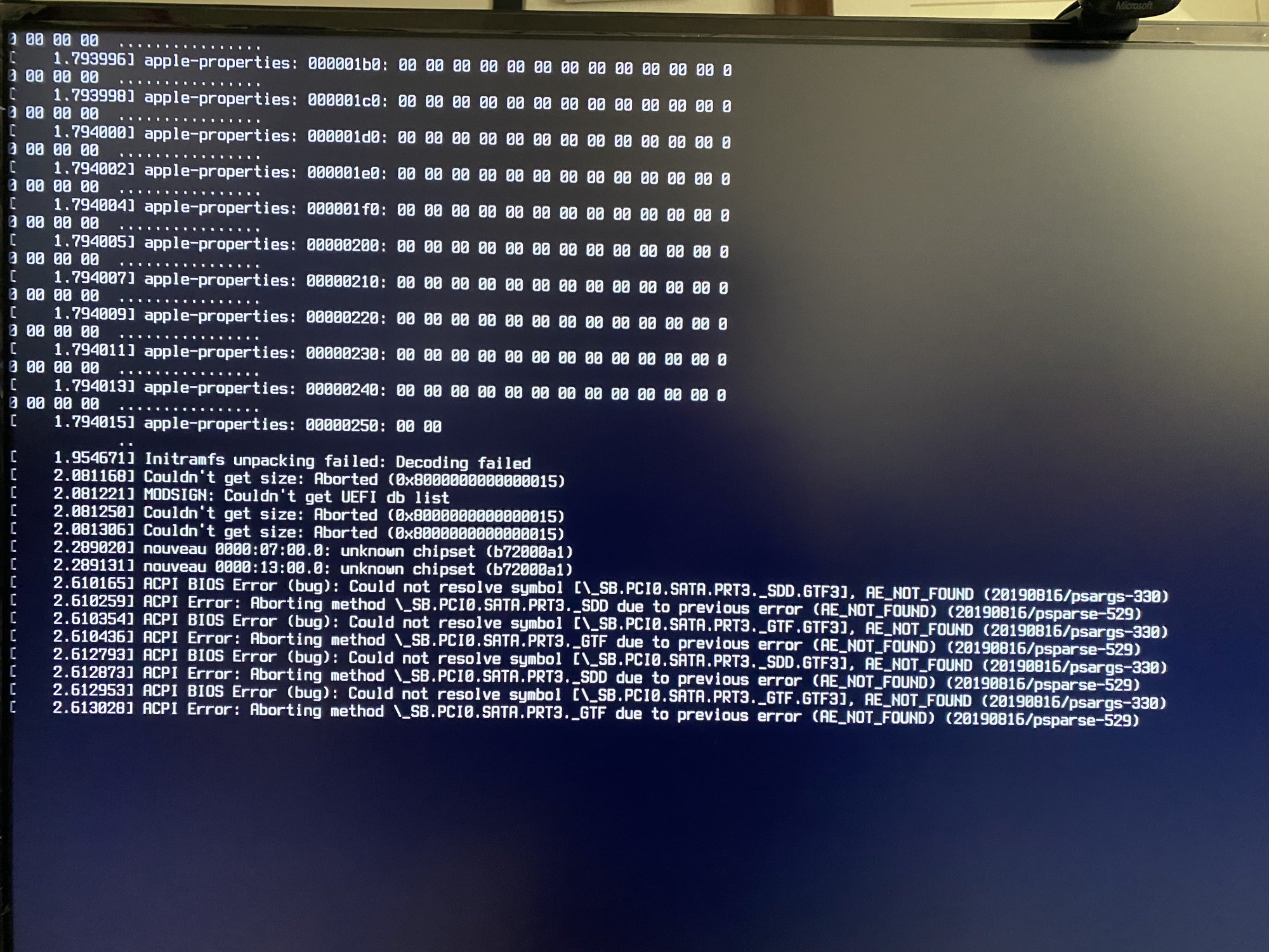

I'm not sure what's going on, but neither the ubuntu nor the PopOS installers work. The PopOS installer just gives me a blank screen and the ubuntu installer gives an UEFI error of some sort. I tried resetting the NVRAM and pulling out some of the SSDs/NVME's. No difference. The last thing I haven't tried is to remove all devices and put the MPX 580 back in and try to install linux to an NVME via a USB-c enclosure and then installing that NVME back inside when installation and setup is complete. The ACPI/BIOS errors are probably my 3x SATA SSD's in the Sonnet J3i storage cage above. The nouveau lines are obviously my 2x nvidia cards. Not sure what everything else means.Any ideas?
Removing the SATA SSD's give shorter but no less serious list of errors:
No "apple-properties" though...
