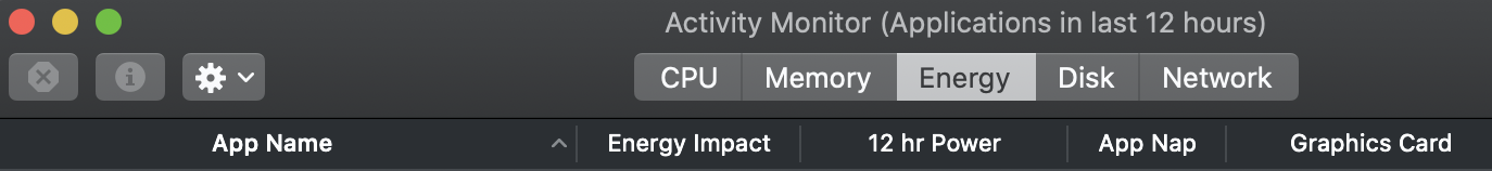

How does the Energy tab in Activity Monitor look like? Checking the list may give you some clues.

I will post a screenshot later.
