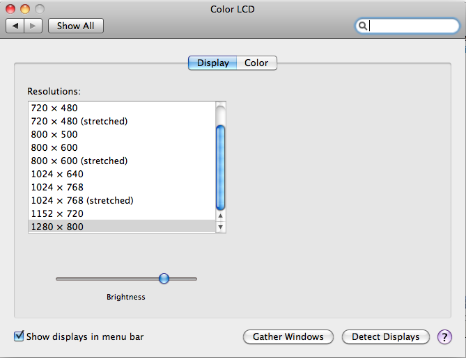

This is as far as my brightness will go up. This is using the keyboard brightness thing on F1 and F2. When I go into the system preferences, I can drag the brightness to the top, but as soon as I release the mouse, it automatically flicks back to where it was before without getting any brighter.

Have you by any chance "Automatically adjust brightness as ambient light changes" enabled in System Preferences > Displays?
Have you tried an SMC reset?
There are very few options under displays in system preferences as you can see in the image below.
