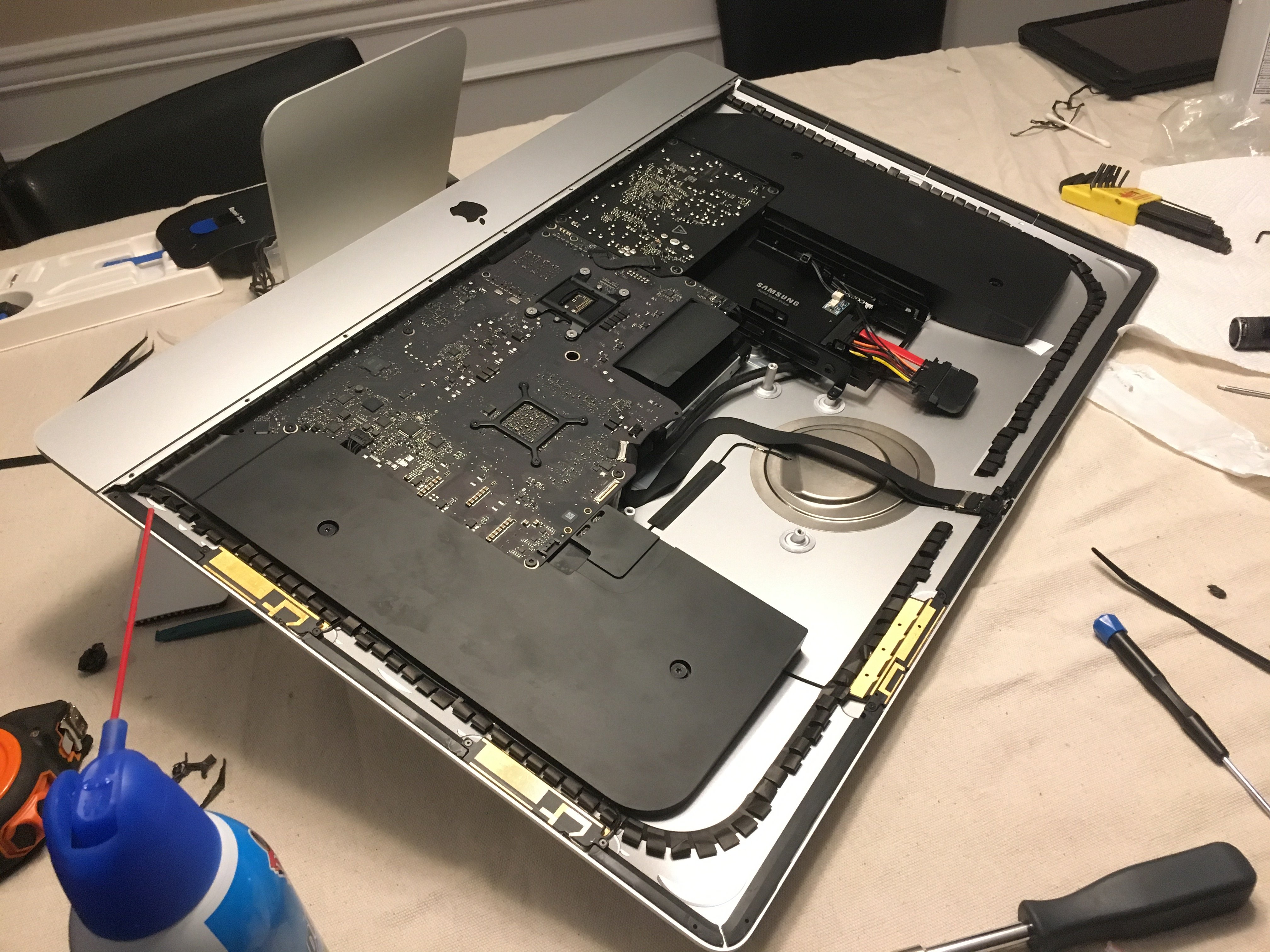

Booo! Got complacent while working on my iMac. I replaced the thermal paste (dried out from years of video encoding and age).
Everything going fine.
Lay the screen back on but it wasn’t quite perfect so go to peel it up a little and....

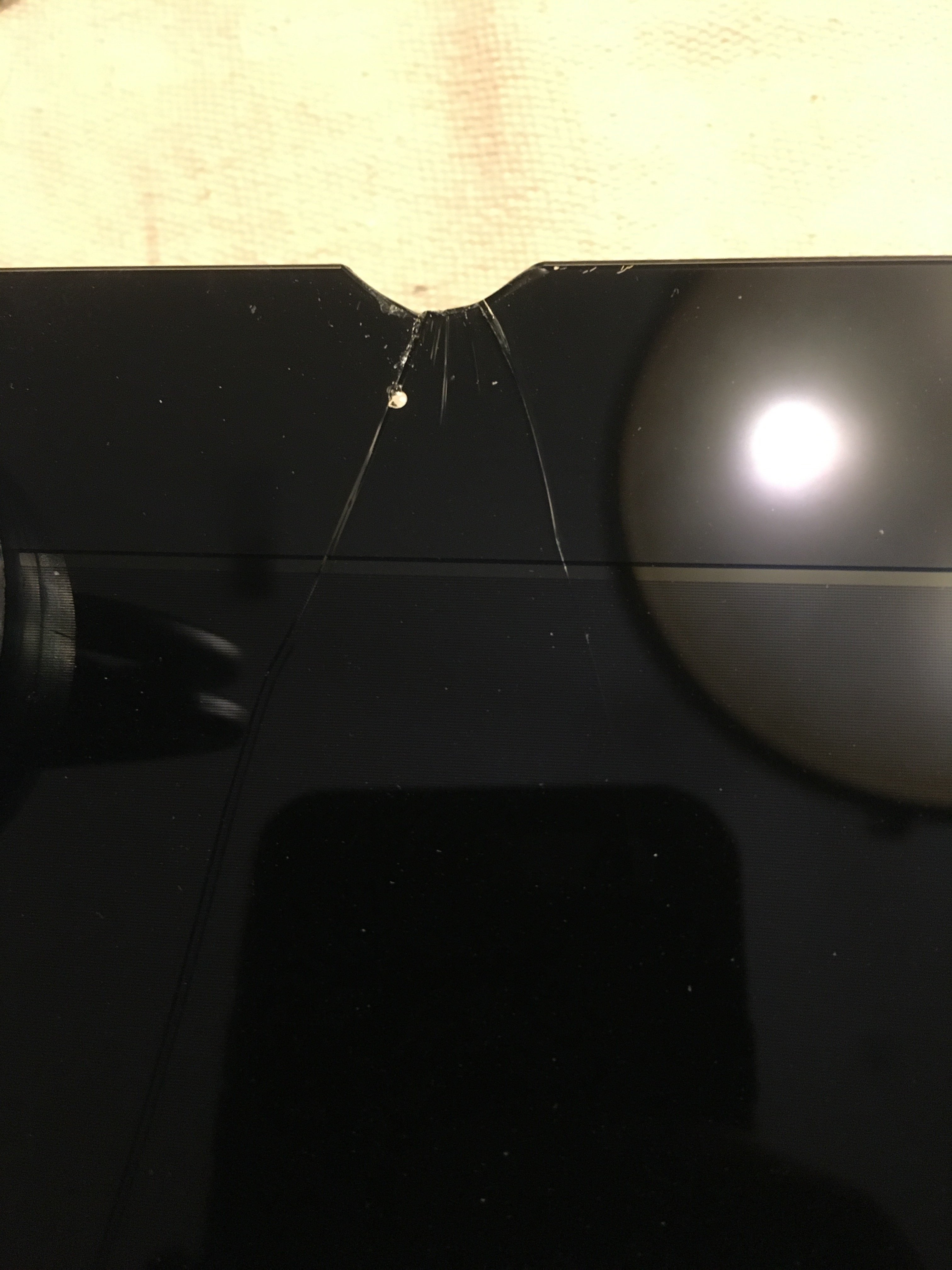

The crack spread to the middle.
I thought, meh I’ll just get new display glass on amazon. Come to find out the LCD and glass are fused and requires a new screen entirely (2013).
What is my least expensive option? I might cut my losses and upgrade on the next refresh unless you guys know of a reasonable deal.

I pried on it in an attempt to salvage the adhesive. As long as you cut the adhesive strips and lift with suction cups you’ll be fine. I just did something dumb.
Just avoid applying pressure in a small area. If it won’t lift off keep trimming at the adhesive.
I’ve done it a dozen times without and issue.

You can't do that.
Once you put in the display, the adhesive is set.
If you didn't align it right, you have to cut the adhesive (again) with the iMac opening wheel and use a new set of adhesive.

The 2010 is much easier and safer to take apart. First off, the LCD and the glass are two separate pieces so if the glass does break the LCD doesn’t need to be replaced just the glass which is way cheaper. Second, the glass on the 2010 is held on by magnets not adhesive so you don’t have to pry on it if it’s misaligned, suction cups take it off easily..

Replacing the Display is a viable option. Expect to pay around £400 for a refurbished 5k iMac Display. If it is a standard iMac a replacement 27" Display will set you back around £300
5k
https://www.ifixit.com/Guide/iMac+Intel+27-Inch+Retina+5K+Display+Display+Replacement/30518
Standard
https://www.ifixit.com/Guide/iMac+Intel+27-Inch+EMC+2546+Display+Replacement/15641
Wow the prices for the 5k replacement display are reasonable!
I was sort of expecting a million billion
