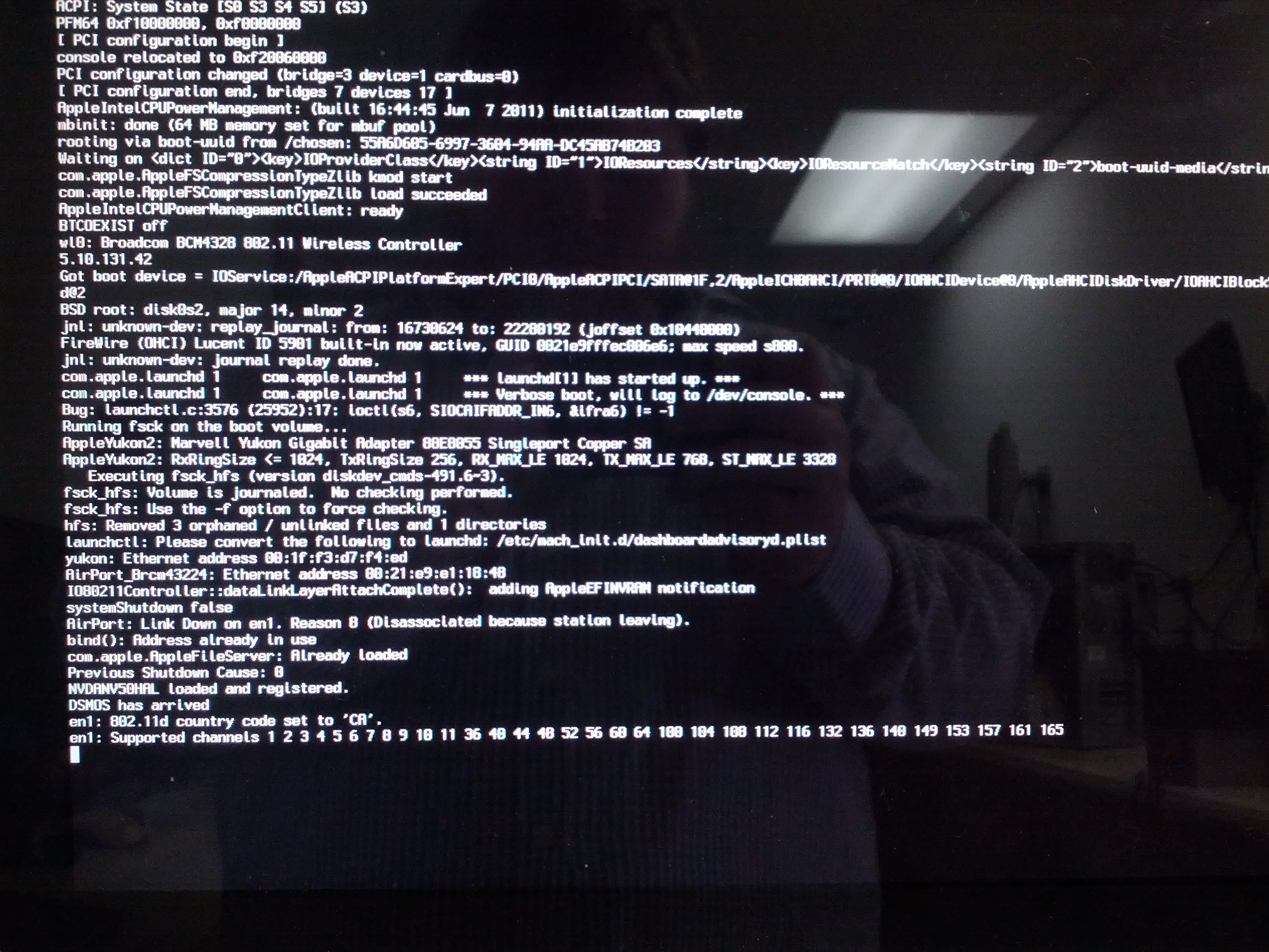

Can you boot to verbose mode (cmd+v) and make a picture when it stops ?

It will be good to see result of EFI and verbose with HDD inside.
Can you post me those ?

I believe that the verbose results may have been with the HD inside, but I am not certain. I will build up the energy to pull it apart again (it's currently completely assembled and looking pretty on my desk) and I will post results later.
