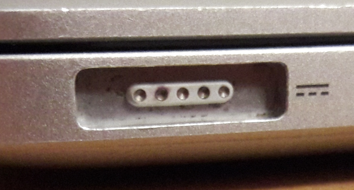

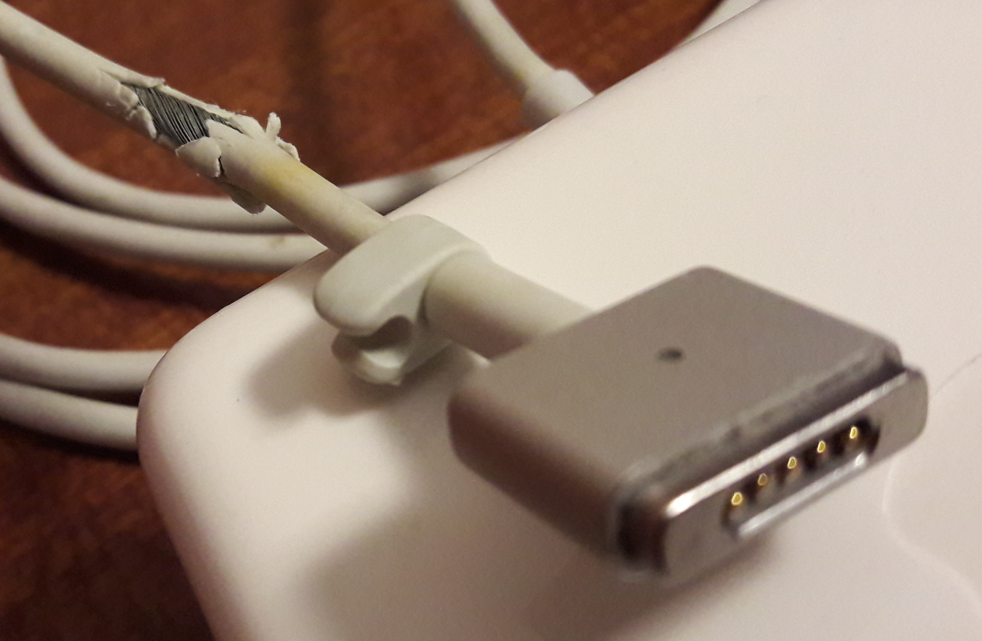

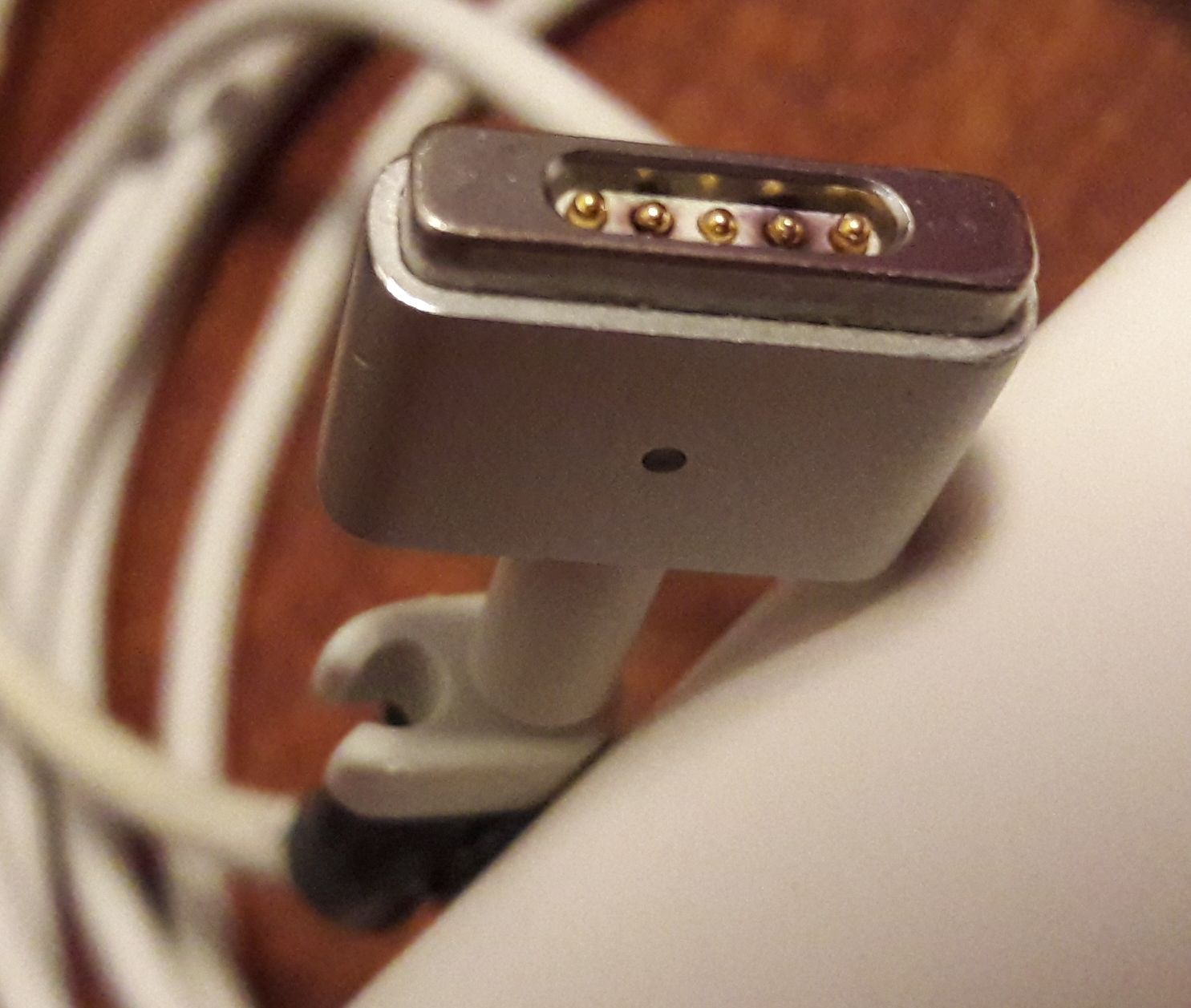

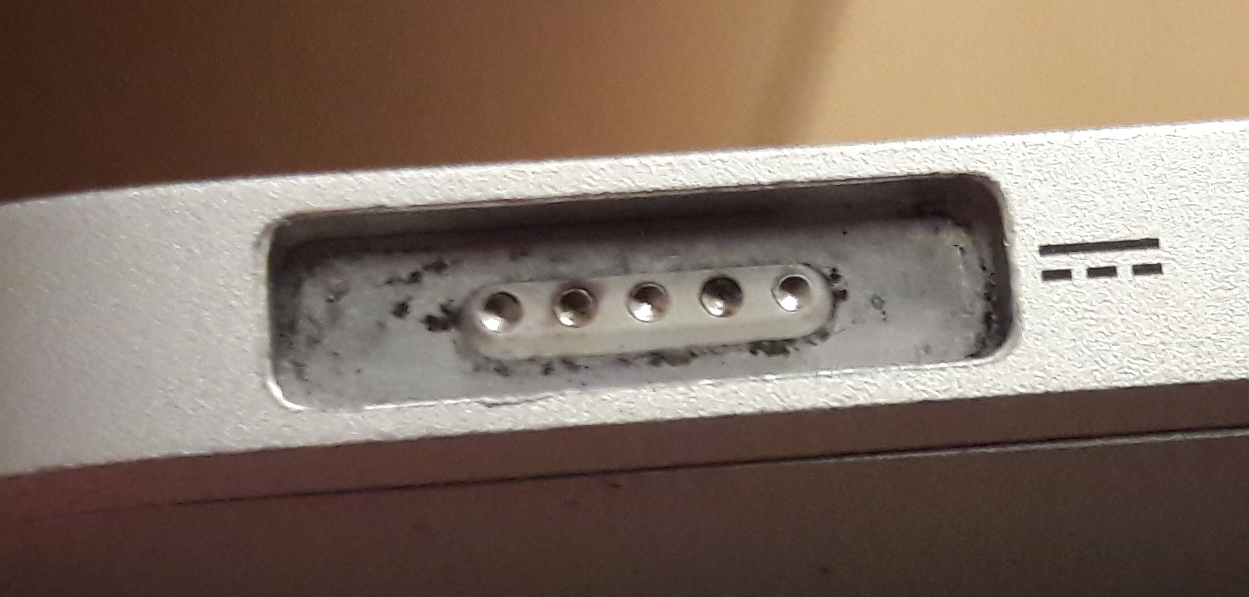

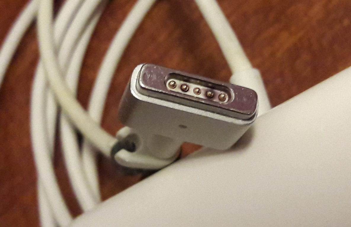

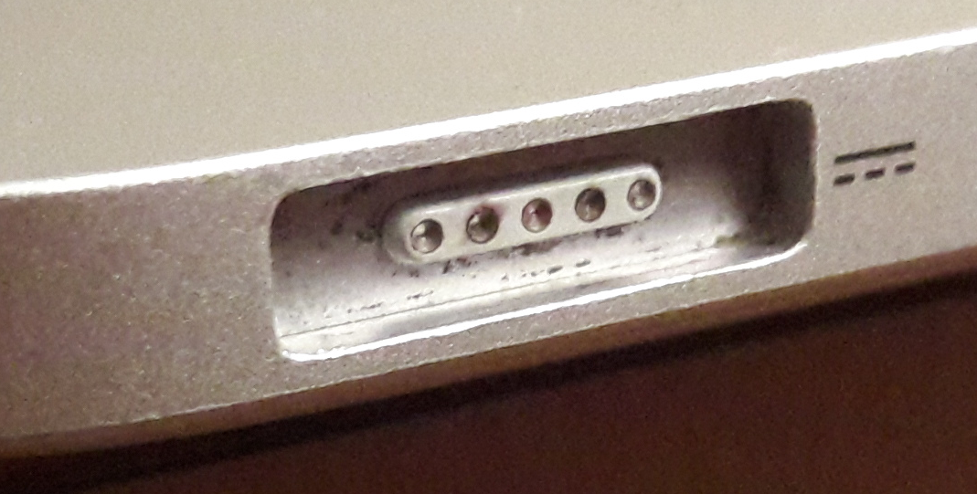

I bought a late 2013 MacBook Pro on eBay and it came with a burn on the pins on the MagSafe DC-In charging port of the MBP, as well as on the pins on the cable of the charger brick.
(Please check attached images at the end of the post)
Judging from the fact that's it's the 2nd and 4th pin that's burned (on both ports), I'd say it happened with this specific charger.
The rubber protective that covers the metals inside the cable is also cut near the port. The seller claims it's from an accident where their kid ran throught the cable or something. I see how that might have caused the rubber on the cable to strain and cut itself, but I don't understand how it could have also caused a burn on the pins.
The seller claims it charges fine. I've only tried charging it once, but it seems to charge normally.
Is this situation dangerous to myself or my MBP? Or I can just apply some insulating tape on the cut area on the cable and I'm good to go?
If it's not safe, does either the charger, or the MagSafe DC-In Board on the MBP need to be replaced?
Thanks in-advance!

Hi,
It seems that the two black pins are stuck, they are a bit shorter. I suspect that this caused some bad contact, which in turn caused the black contacts.
I would put some alcohol or cleaning solvent on the contacts / pins and clean them. Afterwards I would move the pins on the plug with a pointed instrument until they travel freely again and are fully extended.
And put some electric isolation tape around the exposed cable part.
I would replace the charger only if it doesnt charge anymore.
Cheers
Gee
