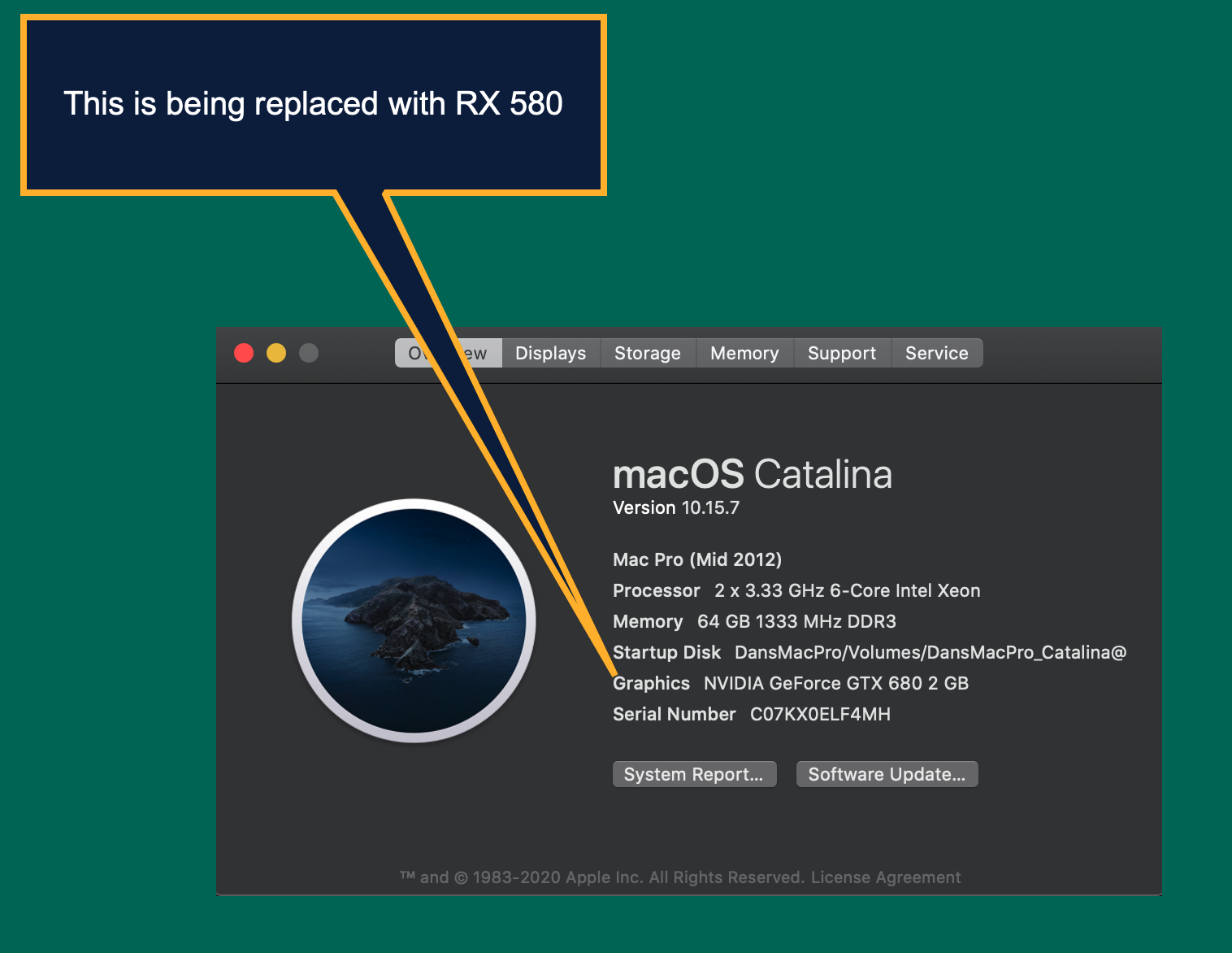

This thread is started in search of a for-sure-definitely-correct yes/no answer.
Looking around, I have not found any claims of 4k graphics coming out of a MacPro using open core.
My question is: Is 4k graphics out of MacPro 5,1 running Sequoia possible? If not, I need to get off this machine. If yes, then will begin diving into details I would rather ignore, but, there it is.
I installed Monterey using Martin Lo's open core. I didn't get the drivers the graphics needed, so I bailed off it.
What I need to know is whether I can run 4k with the most recent releases of MacOS on my machine. It is my understanding that some form of open core is a requirement for running those versions of macOS on this hardware
overdue upgrade of my 2012 MacPro 5,1
I use my mac for programming websites and databases, need current browsers running on it. Need 4k, really want dual 4k monitors, built one suffices. Can it be done with open core and Sequoia.
Catalina is running with the DosDude path, following one of is masterpiece videos.

1. Bringing the Graphics Card Along. Are special notes or procedures required for bringing RX 580 through the upgrade at its full capacity? When I installed Monterey on my cMP 5,1 with the GTX 680, it was not running well. I started asking questions about that and someone asked. "Did you get the drivers you need for the Nvidia card?"
Am I correct in believing the RX 580 with Apple EFI installed (to produce the Apple-Iconed gray startup screens) already has the drivers it will need, that the already flashed-withApple RX 580, will not require flashing or other special processes for the Sequoia w/ Open Core Legacy Patcher?
