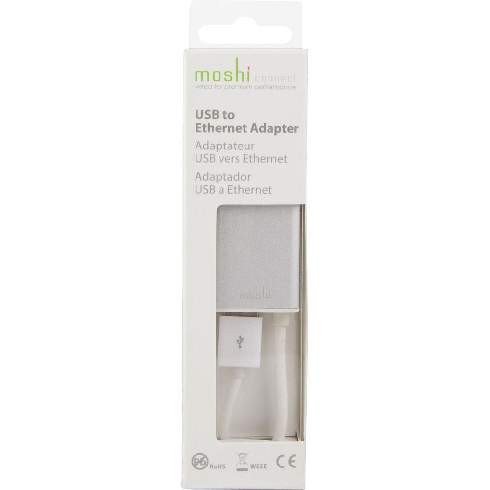

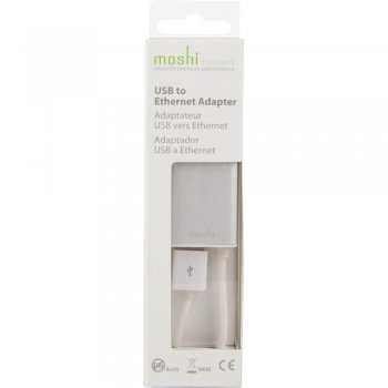

A few months ago @Amethyst1 was helping me to get my two Cinema Displays to work with my work MBP. Both of the adapters I use require two of the three USB ports AND BOTH of the MiniDisplay/Thunderbolt ports. That left only a single USB port, which I need for my keyboard and no TB ports for my TB/Ethernet adapter.
So, I got a Moshi…
It uses the last USB port to connect to ethernet. But it also has a spare USB pass through port so I can attach my keyboard. Not sure how fast it is, but it does work. Nothing to install, the MBP sees it natively.
Moshi also has a USB-C to Ethernet adapter as well.
Correction - I have TWO USB ports. So, the Moshi has one and the keyboard had the other. But because both TB ports are being used I can't use a TB/Ethernet adapter.

From this brief experience Gofanco do not present themselves as a competent organisation and I'll look elsewhere in future when I need hardware. Thanks @eyoungren for the Moshi mention. :)
No problem. I think I paid like $20-30 or something small like that. It shows as a USB 10/100/1000 connection and I've hit speeds of about 500mbps down so it's definitely faster than 100.
