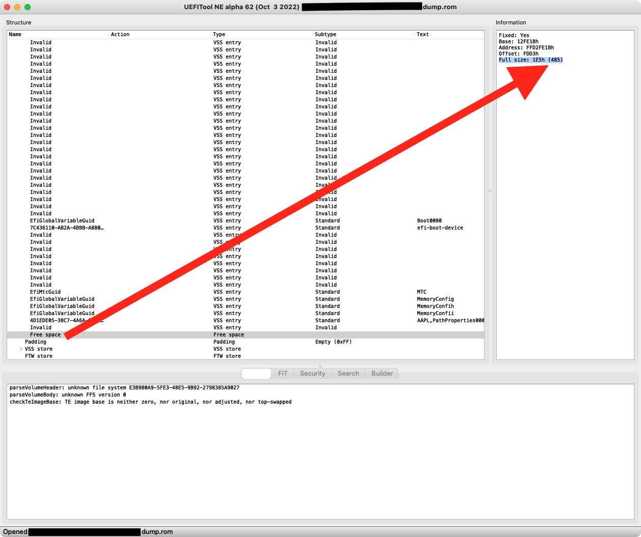

This is really bad, probably the worst I remember, garbage collection failed a long time ago:
