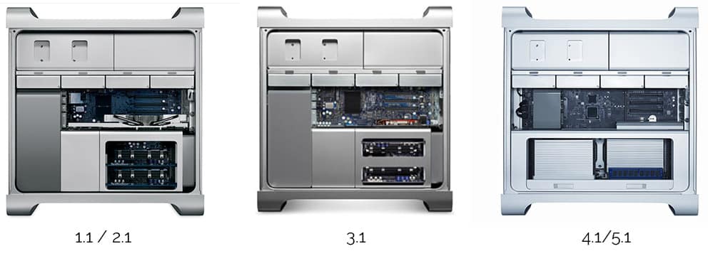

If you can open the side panel, you can at least confirm with 100% certainty if it's a 3,1 or not:
Source: https://blog.greggant.com/images/posts/2018-05-01-macpro/comparemacs.jpg
edit: The 4,1 / 5,1 lacks the second grey heatsink in the lower bay for single processor models.
If you can open the side panel, you can confirm at least the 3,1 or 4,1 mystery:
Definitiv the middle one 3,1 @tsialex
maybe found the missmatch named Spoofing the Hardware ID :), i´ll will check it Tomorrow again.
