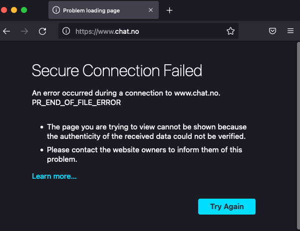

And accessed through a VPN server in Norway:
"Secure Connection Failed
An error occurred during a connection to www.chat.no. PR_END_OF_FILE_ERROR
The page you are trying to view cannot be shown because the authenticity of the received data could not be verified.
Please contact the website owners to inform them of this problem."

Both say it's down
"Is Chat Down Right Now?" https://www.isitdownrightnow.com/chat.no.html
"Down for Everyone or Just Me" https://downforeveryoneorjustme.com/chat.no

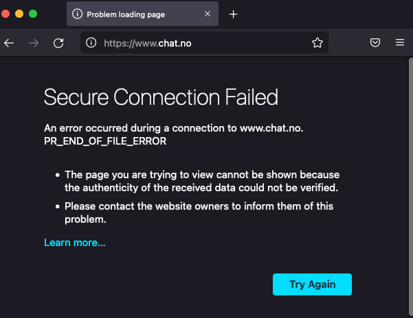

Now that's convincing!
Accessing the server by domain name gets no response at all. Accessing the server by IP address gets an immediate 404. So, when accessing by IP address, the unavailable resources which do not respond are not even being contacted.
I'd be very interested to see what happens when one tries again to access by IP address once the server is back up.
