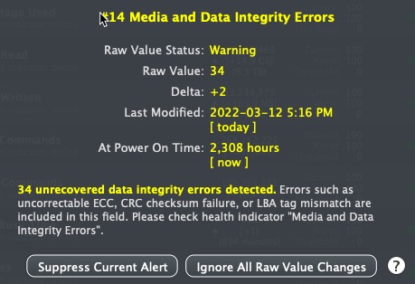

I’ve been trying to copy over my iTunes Media folder from my Mac mini (with Samsung 970 Evo NVMe SSD) onto an external drive to transfer over to my other MBP. Tried 2 external FW drives and a USB Flash Drive with no success. 18 gigs of my 52 gig folder gets copied over and then comes up with the error 100083. Any ideas?
DriveDX just presented this to me so there is something going on with my new Samsung 970 Evo.

My internal Mac mini is NVMe SSD. My external HDD Firewire drive clone volumes are formatted APFS as well. The other volumes are HFS+. The error is coming from DriveDX installed on my Mac mini SSD. The error came even when copying over to the volumes formatted as HFS+.

My SuperDuper clone is nearly finished. DriveDX popped up twice during the clone and now is reporting 63 errors. I suppose my HDD volumes should all be HFS+. Not sure if that's what would cause the errors. I've never used Migration Assistant. Probably should give it a try sometime. I've always like manually copying over files.
