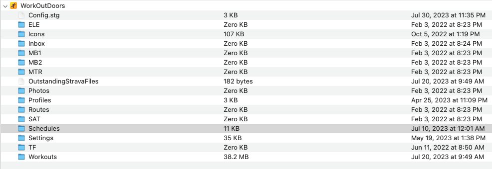

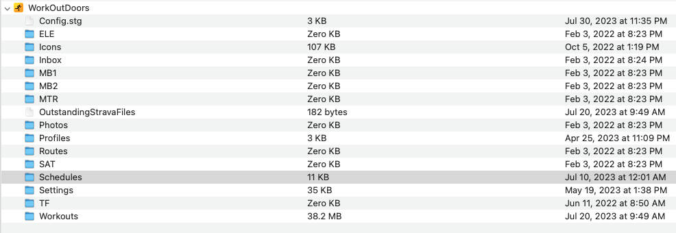

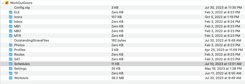

For WorkOutDoors app, which files or folders should I copy over, I am thinking Schedules, Settings and Workouts? Is that correct?
How do I transfer the files from the phone app to my Mac? I didn't find any files in the File app on my phone
Use the Apple support links in the post and that worked on my Mac.
Yes, those are the most important directories. The Config.stg file is useful too.
Thanks so much for the responses and support. I was able to get my workouts restored, but the config.stg did not restore my workout screen configurations. But that’s a minor inconvenience and easier to deal with.
Sorry, I should have mentioned that the screen configurations are in the Profiles directory.
