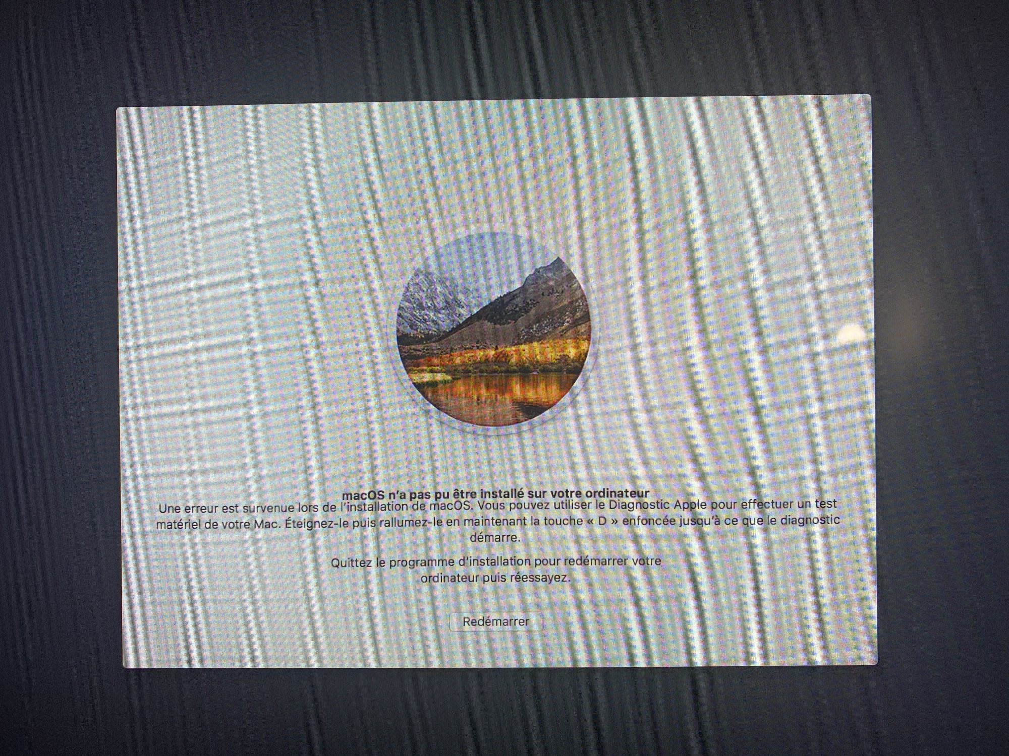

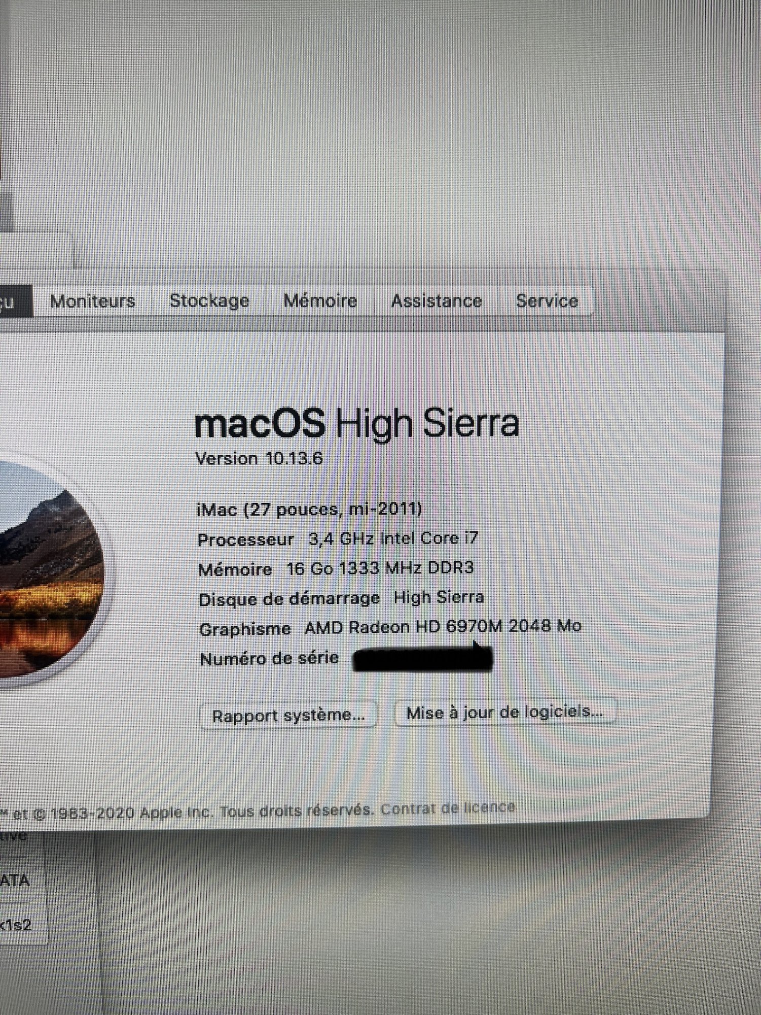

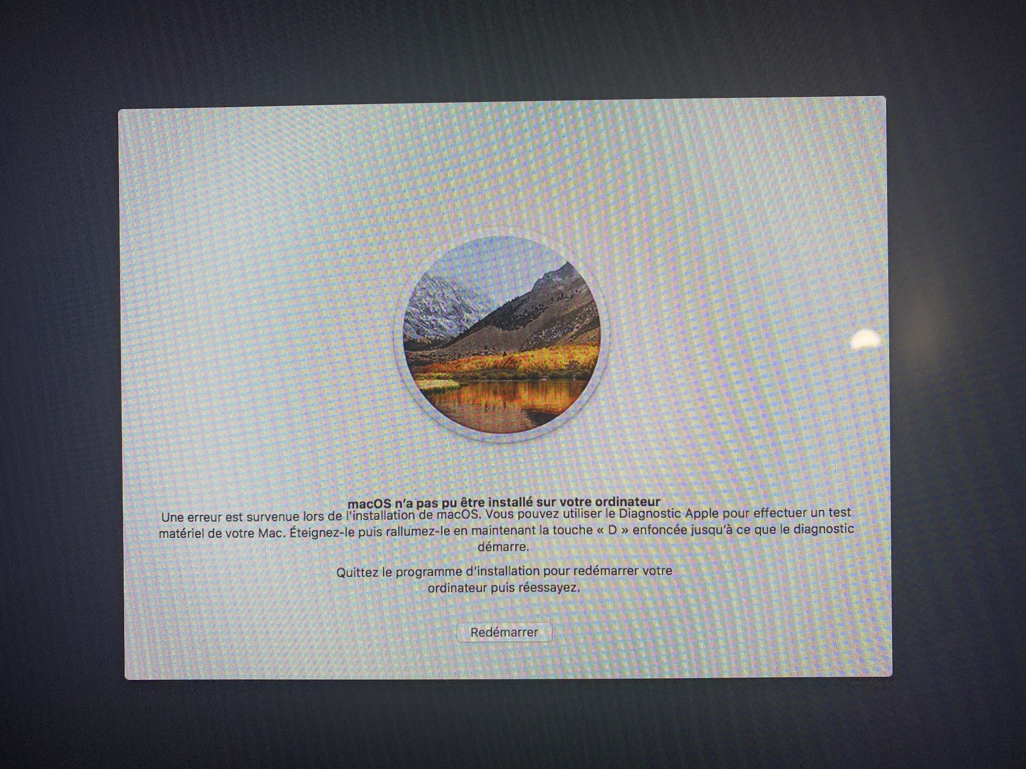

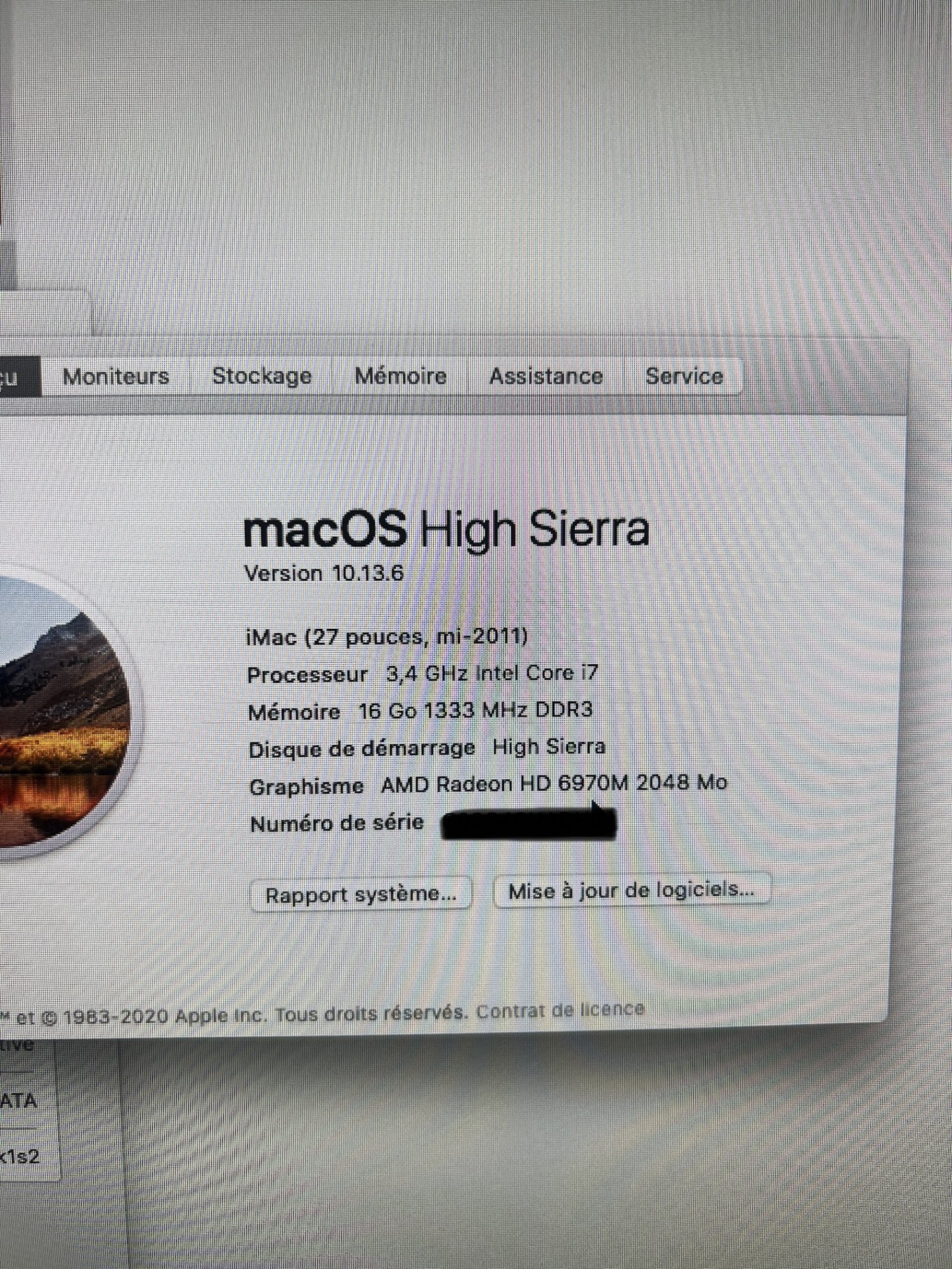

i've met the same problem, eh maybe not exactly the same, i've mi 2011 27", it worked fine with i5, but i upgraded the cpu i7, video card, rams, and changed to a ssd + hdd system , then the problems came: imac can install el capitan, but can't install any mac os all versions after el capitan, nor sierra nor high sierra, of course cant install opencore catalina or others, the same issue after first reboot here attached screen shot: "mac os cant be installed on this mac" (sorry the screen language was in french), i can't even clone from a external disk with system, it crashed at the 90%, yes i did changed the date, and deactived the csr service, i dont know what i can do now, any one get a clue to help please? many thanks!
btw when i had high sierra on old hdd, i cant install the last security update download from apple server, 2020-006, it can run in system, but after reboot, the installation stopped or crashed at 70% always, hope can find a way here to install it, thanks
