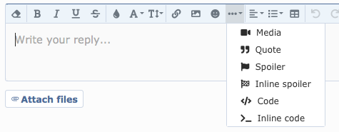

Finally, the Code tag is better than the Quote tag for posting code.

Fixed QUOTE/CODE - my bad... not sure where my head was.
