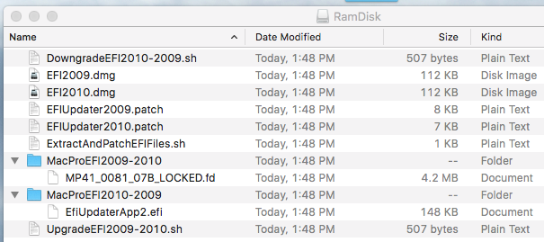

What does your RamDisk look like. Mine looks like this and I think it's wrong, mostly because I get the same RamDisk even when Tool fails.
Most of the people are getting it done just fine and some of us are failing. It's genetic probably.

Well I've done some work from info within the scripts and from excellent work by pigsyn on GitHub. I've basically hand-constructed a RamDisk and even just put a manually-processed file into the Updates folder. it looks like the Tool is working correctly in my environment. The problem seems that my specific 4,1 (unlike others I've successfully upgraded in the past) simply has some inherent impediment. It simply doesn't want to burn this even though it seems to have been set up correctly to perform it.
The confusing thing to me is the many reports from people who have changed OS's and suddenly the burn took. From El Cap to Mavericks and Yosemite or the other way around. I can only suspect at this point that they were making some other procedural error and the change of OS was just coincidental with them simply doing it right at last.
