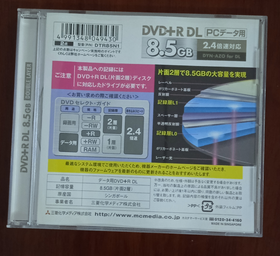

Are you burning them to +R DL or -r DL? Leopard will not boot if you burned it to +R DL. This isn’t the place for this and I won’t go to far into it but in my hackintosh days leopard and snow leopard use the have issues booting from +R media because there technically data only type media. They need to be -R DL or you can get the leopard image to fit on a single layer dvd. Just search Leopard Single layer and I think there’s an image on the Macintosh garden and I know there’s one on the internet archive as well. But again it has to be -R alternatively the late generation PowerBook G4 had an open firmware that let will let yoy simply create a leopard usb and boot by pressing option at startup. There’s instructions on the garden for that as well and actionretro on YouTube also has a tutorial if you prefer watching a tutorial
But I have a different experience. This DVD+R DL 10.5.0 install disc is bootable. I've been using it to install 10.5.0 to my MDD Mac and for troubleshooting since 2007.
