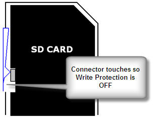

Solution: reinsert the SD card. After spending ages trying to figure this out, I've discovered that the way you insert the SD card into the MBP's SD card slot alters its Sharing & Permissions. Instead of sliding it in, I gave it a firm tap and Permissions read: read and write. When I slowly slid it in again, no firm tap this time, I got: read only. Bizarre. I assume it's a contacts problem. I found this solution on another forum, so another person had the same problem.
I found out that the problem is related to the lock sensor on the sd card reader. If you leave the lock latch between locked and unlocked it will work properly
This has been driving me crazy! Just bought a 8gb Sandisk SD card which writes well in my wife's VAIO but is 'read only' in my MBP. I did the above and with the switch at very nearly half way down it gave me 'custom access', but still couldn't write. Then a millimetre more and it gave me the coveted 'read/write' access and disk utility could find it (though still can't format - had to use the VAIO).

I believe the issue is with the size of the latch on the SD cards, since some work very well. If you notice, those that have this issue have a very small latch. Don't know for sure though.

[doublepost=1508100077][/doublepost]thanks for this, this has actually been driving me batty for ages and the nudging it on bit by bit worked a treat, i started with it in locked state and moved it on as you suggested until it came alive
