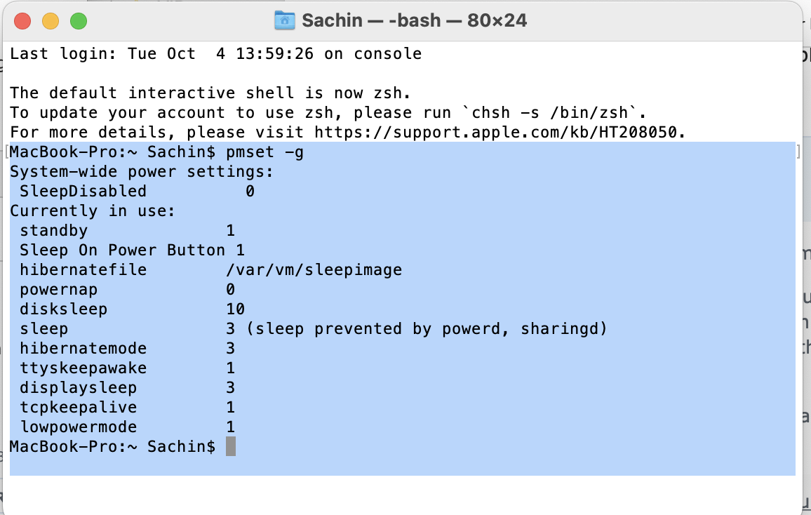

This sounds almost exactly like the 'halfdim' setting available in the 'pmset' command. Here's a man page for it:
halfdim - display sleep will use an intermediate half-brightness state
between full brightness and fully off (value = 0/1)
Note that this setting is distinct from 'lessbright', which is the typical one that dims slightly when on battery.
The first thing to do is find out what your settings are. Do that while it's on battery, so the then-current settings are listed.
Type this command into a Terminal window:
Code:
pmset -g
The output will be a bunch of text. Use drag-select to select it all, then copy and paste it into a post here.
EDIT
I'm much less sure it's related to 'halfdim', now that I checked it on an actual laptop. The 'pmset -g' output on my older MacBook Pro shows halfdim is 1, but I don't have it set to dim on battery.
It would still be useful to see the output of the 'pmset -g' command, so please post that.
Hi, thank you so much for assisting. Output attached
Hey
If I understood correctly
Turn off "low power mode" on the Battery section
Brilliant! Thank you so much - that worked. I searched the internet for this issue and never found this as suggestion. Thank you again :)
Reactions: appltech
