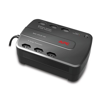

Didn't try, but perhaps you could use a no-break with USB connection cable, like this APC one:
Perhaps it will be recognized as a battery and OSX won't refuse to install. I use this no-break with a Mac Mini an it is recognized as a battery, like if my Mini was a laptop. Of course I have to plug its included USB cable to my MacMini, so it can be found by OSX. It's a pretty common equipment, maybe you have a friend who owns one.

brdeveloper is referring to an Uninterruptible Power Supply. These can look like a battery to operating system when they are connected via USB, which all but the basic models will have.
