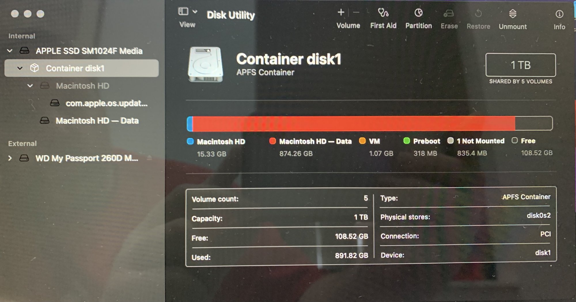

Hey folks,
I have a sick late 2013 15 inch Macbook pro. The symptom is that it keeps shutting down without any crash report. It seems stable in safe mode. I took it to an Apple store. They replaced the very worn battery, saying it would be the cause. I picked it up, and sure enough, it’s still happening.
I’m figuring I better try a reinstall before going back to Apple.
I have a fair bit of data (800GB, also backed up in 2 locations). I can wipe the drive if needed to make the install clean.
However, since I first set this up, I’m guessing there have been a few changes done by OS upgrades. At one point my main data folder was shifted to a Previously relocated items folder, and there now appears to be a separate Macintosh HD partition.
Do I need to wipe the entire drive to make sure the OS isn’t an issue? Do I need to do the same to make sure it isn’t third party software?
Any help appreciated.
Cheers
The stability in Safe Mode is a good indicator of a likely software issue. As for culprits, any software with and extensions, including security, VPNs, etc. are possible sources of instability, panics, or crashes. Sometimes it is a combination. Had a bunch of Macs at work that were not stable with both a particular versoin of AV software, VPN software, and a recent OS patch. It happens.
If you have an extra external, you could do a clean OS install to it, and boot to it. It will feel slower (depending on drive type/speed, bus speed, etc), but you could run it that way to test for stability.
You could also clone your existing OS to an external and have it fully bootable, so that you can wipe the internal drive and then do a fresh OS install. With the bootable clone, you can always clone back to if you want. CCC (free trial) can do this for you.
The partition you see is the new normal, so nothing to worry about there. If you choose to erase and start fresh, reformat the "Macintosh SSD Media" itself, and it will automatically erase and rebuild the default containers and volumes.

Thanks for all that info. I don’t have a free external drive to test with (my two have backups on them). If I can pick your brain further…
If I wipe and re-install, can I restore individual apps using the migration assistant? I figure there are only a few core apps I need, and it would be great to test by restoring one at a time.
